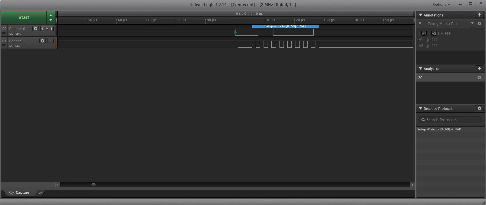

I am trying to establish an I2C Connection between the two boards, but the slave (being STM32F4) is not being acknowledged by the Variscite Board.
Desired setup:
- Variscite DART-6UL as the master
- STM32F4 as the the slave.
The Variscite master is set up properly. When I try to read a byte from my slave with the command i2cget 0 0x0A 0x00, I get ''Error: using read byte''.
I think my set up is right, for the varisite board the I2C1 J11 (Pin 5 SCL line) is connected to PB6 of STM32, and the I2C1 J11 (Pin 7 SDA Line) is connected to PB9 STM32F4.

So this tells me that my master (Variscite) board is not detecting my master. I also tried sampling my transmitted data with Salae Logic Analyzer. Based on the image below, its writing to the wrong address, it writes to 0x14 [NAK], but I specified 0x00 for my data address and 0x0A as my chip address, so why is it writing to 0x14?
So again, slave is not being acknowledged. But I have no idea how to get the slave to acknowledge.
Update
I believe my problem is that Slave is not able to receive properly. The data is actually sending to the correct address 0x14 (I forgot that I had to shift it to the right 1 because of the R/W ACK bit). I used HAL_I2C_Slave_Receive
