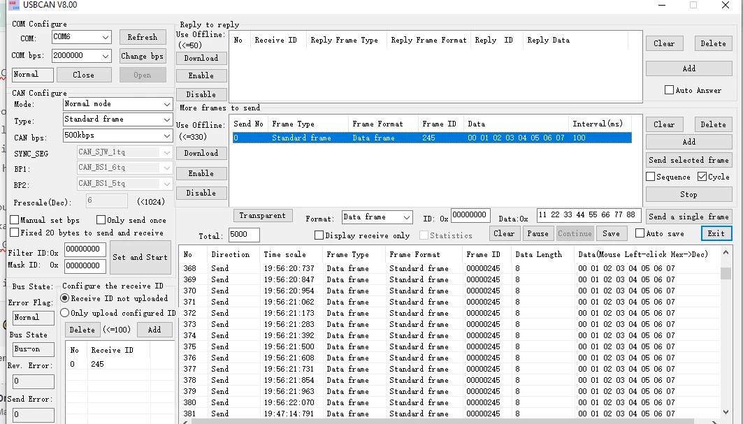

Below is my message which I am sending from USB-CAN Analyzer.

I am getting form error in CAN_ESR. According to my above configurations correct my bit timing configurations.

Need to check you bitrate config + the clock source config: need to have the same CAN bitrate as your CAN analyzer + If you are using HSI you need to change it to HSE with an external crystal.
But as a starting point use Loopback mode to at least validate your send/receive operations. If in Loopback mode doesn't work, it doesn't work also for Normal mode.

In that case I suspect the following issues:
1- A HW issue: check your wiring, the power supply of the transceiver , your transceiver connections, termination resistors. In that case you need to provide schematics of your board.
2- Bit timing issue: are you sure you have the same bitrate config as for your CAN analyzer?
3- The clock source: are you sing HSE and a crystal? if not you can face issue with CAN communication in normal mode.
You need also to share your project as requested previously.

Tips in CAN communication:
When you face an issue in normal mode start by using Loopback mode at least to validate your Software and filters config. Because it could be something related to your HW. You can refer to this example: https://github.com/STMicroelectronics/STM32CubeF4/blob/master/Projects/STM324xG_EVAL/Examples/CAN/CAN_LoopBack/
Meanwhile, you still using a bad CAN config. You assigned FIFO0 to the filter but you activated FIFO1 interrupt.
can_filter.FilterFIFOAssignment = CAN_FILTER_FIFO0;
	// Activate the notification
	HAL_CAN_ActivateNotification(&hcan1, CAN_IT_RX_FIFO1_MSG_PENDING)
void HAL_CAN_RxFifo1MsgPendingCallback(CAN_HandleTypeDef *hcan1)
	HAL_CAN_GetRxMessage(hcan1, CAN_RX_FIFO1, &rx_header, rx_data);
PS: regarding your question about the usage of HAL_CAN_GetRxMessage(); refer also to the example I pointed out above (loopback mode) where it has used as follows:
