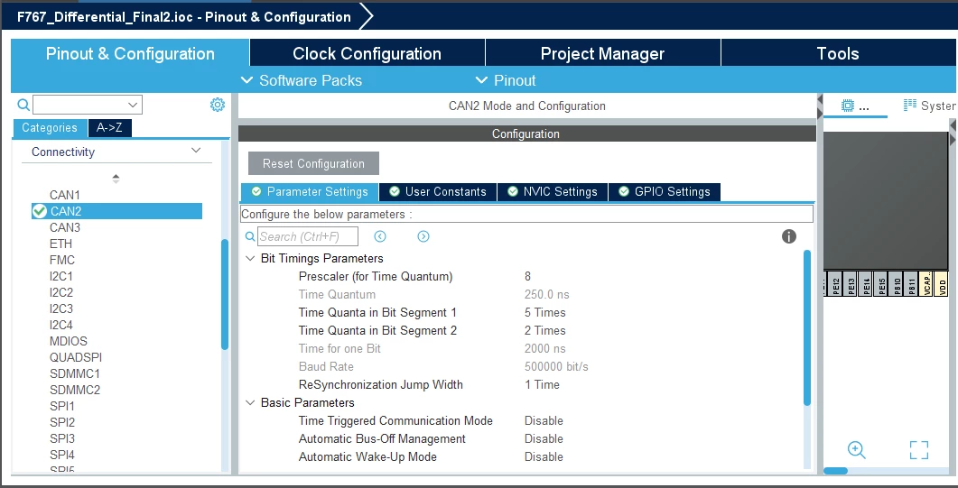

Changed timing parameters for CAN to get a simple point at ~85%.

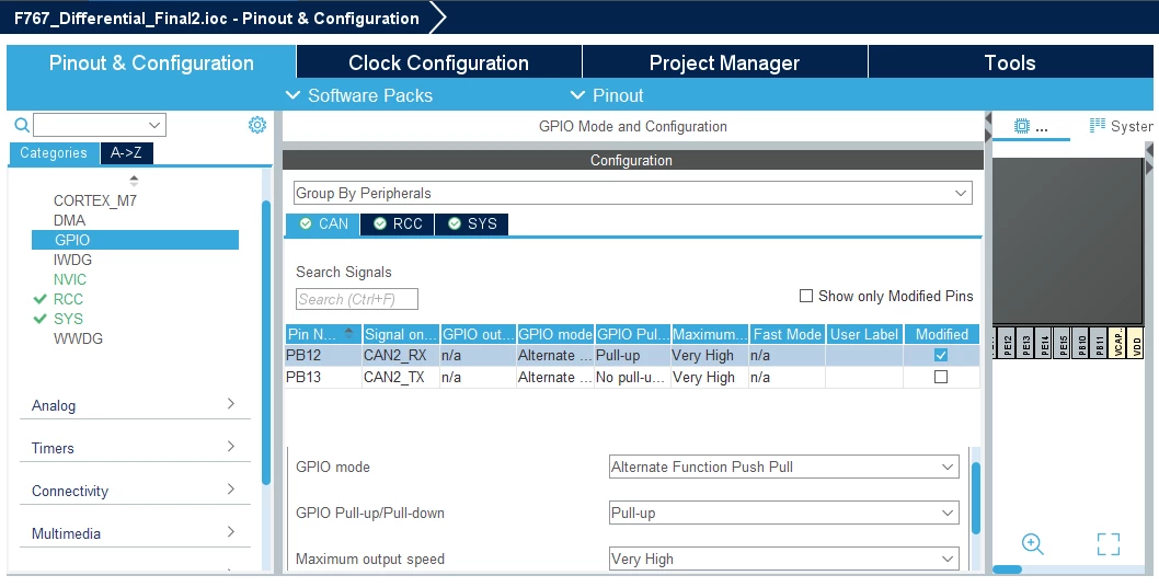

According the Nucleo board schematics PB13 is connected to RMII_TXD1 over JP7 (if you didn't remove it it could cause an issue)

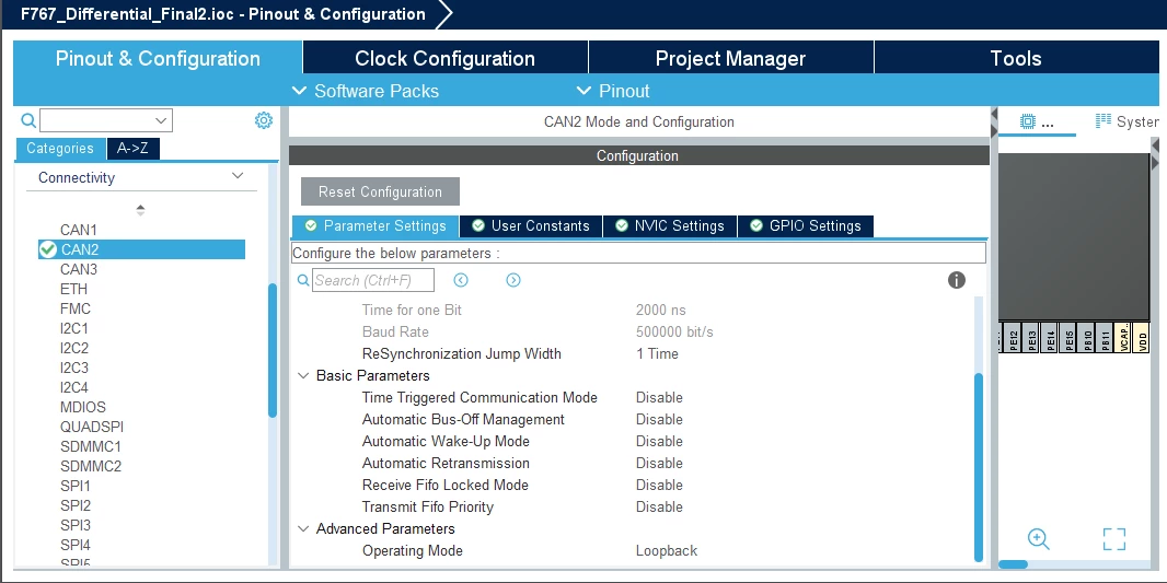

I have tried sFilterConfig.SlaveStartFilterBank = 0. But I still haven't gotten any result. and i am only using one CAN that is CAN2

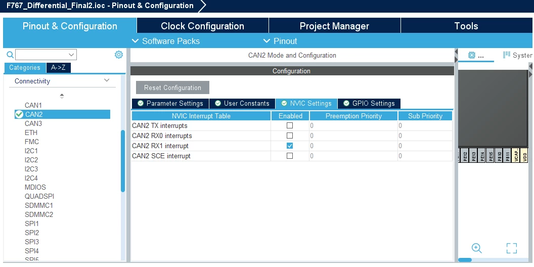

You have also another issue. The usage FIFO is wrong:
Here you assigned the filter to FIFO1 and you activated the interrupt on FIFO1.
sFilterConfig.FilterFIFOAssignment = CAN_FILTER_FIFO1
if (HAL_CAN_ActivateNotification(&hcan2, CAN_IT_RX_FIFO1_MSG_PENDING) != HAL_OK)
But here you are using FIFO0 callback and in the callback you are receiving data from FIFO1 which doeasn't make sense:
void HAL_CAN_RxFifo0MsgPendingCallback(CAN_HandleTypeDef *hcan)
HAL_CAN_GetRxMessage(&hcan2, CAN_RX_FIFO1, &RxHeader, RxData);
Here you are using the incorrect callback. So, replace HAL_CAN_RxFifo0MsgPendingCallback by HAL_CAN_RxFifo1MsgPendingCallback

Here are some pictures of IOC file configuration for CAN:
Screenshot (28).pngScreenshot (29).pngScreenshot (30).pngScreenshot (31).png
