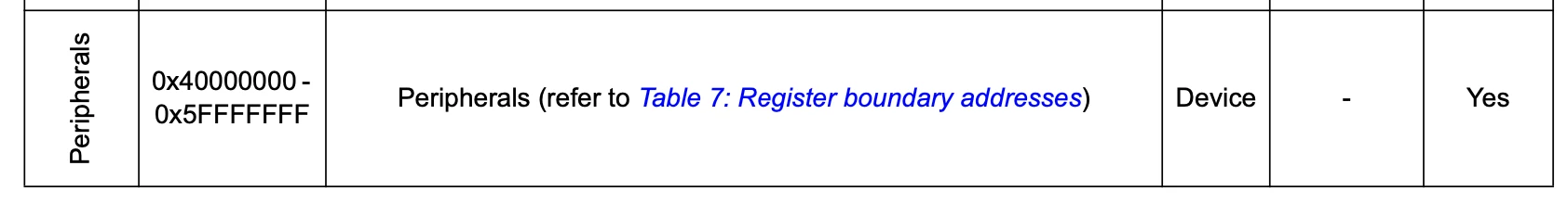

RM0468 Rev 2 - Table 7. Register boundary addresses
0x5200B400 - 0x5200B7FF - OCTOSPI1 control registers Section 24.7: OCTOSPI registers

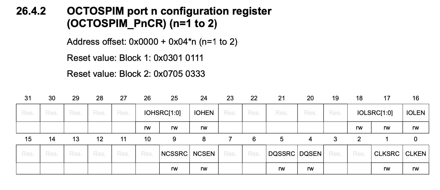

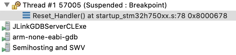

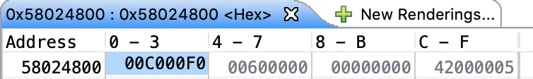

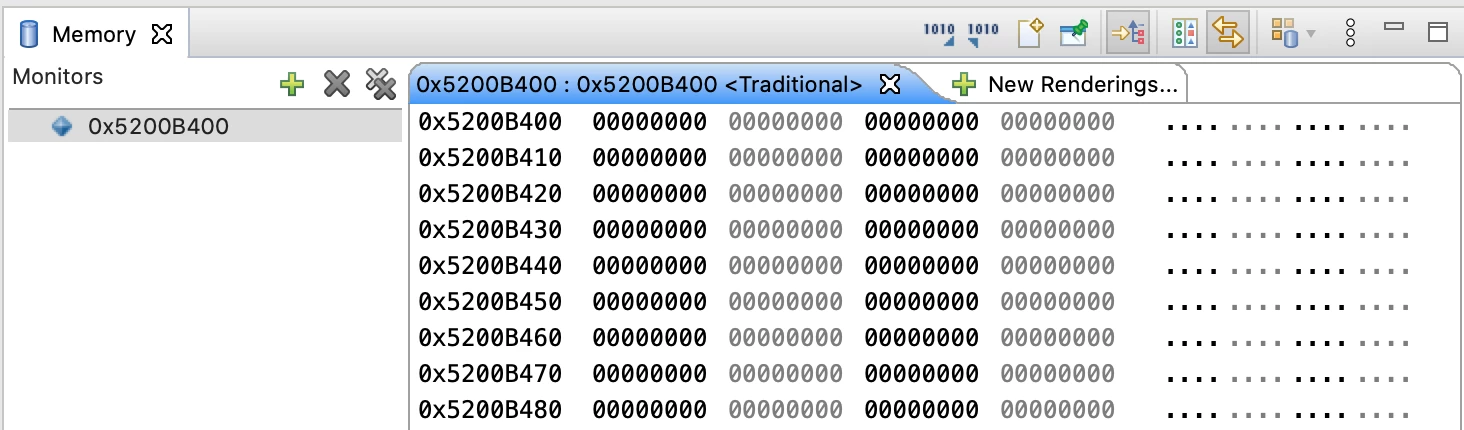

Connecting a debugger, halting the CPU in the Reset_Handler before any code runs and inspecting the memory at the location results in the following:
0693W00000AM2h6QAD.png0693W00000AM2h1QAD.pngExpected default values:
I'm unable to configure the OCTOSPIM peripheral on at least two CPUs.

I verified the problem on BOTH designs. Any attempt to write or read to the OCTOSPIM periphal has NO EFFECT on both designs. Multiple PCBs built, all silicon has the same issue.
I *am* able to read other non-zero reset values using the debugger and other code, such as the defaults for the PWR control register 1.

1) Is the base address correct?
2) Is the silicon bad?

Andreas Bolsch
Lead III
Apr 21, 2021 9:31 AM UTC
Clock for OCTOSPIM enabled? The name is somewhat misleading: IOMNGREN in RCC_AHB3ENR.
dominicc
dominiccAuthor
Apr 21, 2021 10:40 AM UTC
Hi Andreas,
The OCTOSPIM does not have a clock. OCTOSPI has a clock. The issue is with the OCTOSPI MANAGER peripheral, not the OCTOSPI peripheral. Regardless of clocks, reading/writing the OCTOSPIM registers should be possible, but reads/writes to the documented registers has zero effect.
As noted, on one of my designs for which the default configuration of the OCTOSPIM periphal does not need changing, the OCTOSPI peripheral also works and I'm able to use Winbond 16MB QuadSPI flash chip via the NCS/CLK/IO0-3 GPIO lines.
Andreas Bolsch
Lead III
Apr 21, 2021 11:21 AM UTC
Yes, I know that you're referring to OCTOSPI*M*, not the OCTOSPI. And no, it does defintitely have a clock for register accesses, from the RM:
"Bit 21 IOMNGREN: OCTOSPI I/O manager clock enable
Set and reset by software.
0: OCTOSPI I/O manager clock disabled (default after reset)
1: OCTOSPI I/O manager clock enabled"

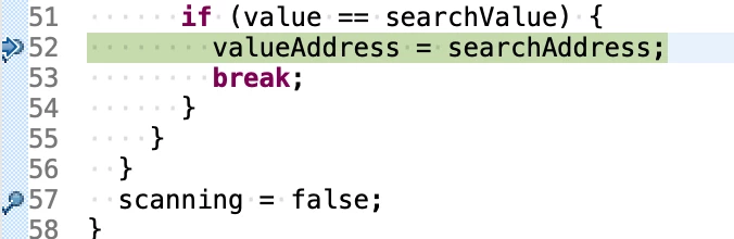

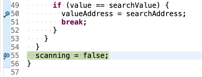

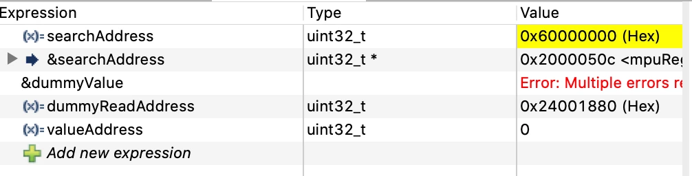

Further to this I created a tool to scan the entire peripheral address space for known peripheral register addresses.
https://gist.github.com/hydra/f2cffb9e590ec7a203c0ff3b6462c051
The tool does *NOT* find the value for the OCTOSPIM_P1CR or OCTOSPIM_P2CR in the documented peripheral address space.
0693W00000AM6hKQAT.png0693W00000AM6jkQAD.png0693W00000AM6jfQAD.pngIn these screenshots the breakpoint is at the end of the scan, the searchAddress reached the end of the peripheral address space.
Given this, I currently conclude that the OCTOSPIM peripheral cannot be accessed in the MCU and that there's a silicon bug.
