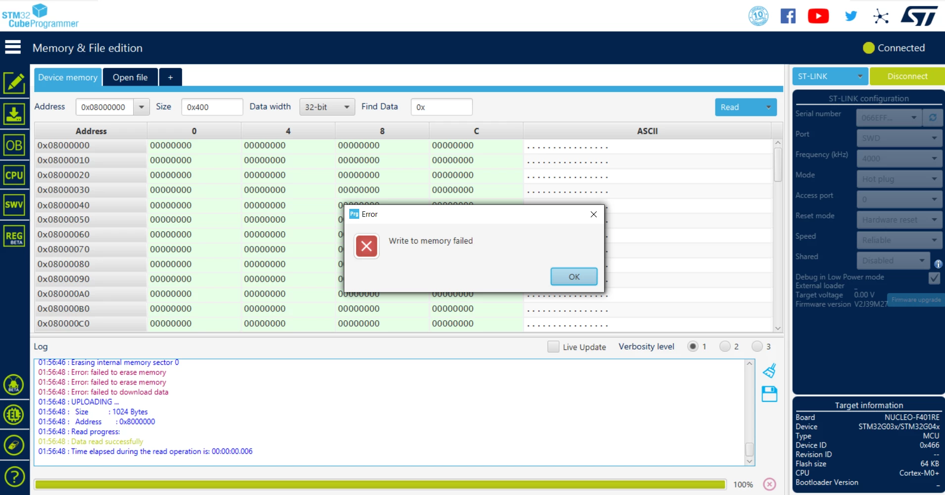

Hello, I am not able to program STM32G031. I have Nucleo kit F401RE and STM32G031 connected to SWD. I have connected SWDIO, SWCLK, 3V3, GND and nRST.
STM32CubeProgrammer can connect only in Hot Plug mode, but writting or errasing gives me: Error: Mass erase operation failed.Please verify flash protection
If I try to connect in Normal mode or Under reset mode, the error is: Error: ST-LINK error (DEV_TARGET_HELD_UNDER_RESET).
Can you help me how to continue? STM32G031 is completely new, never programmed before.
ST-LINK FW : V2J39M27

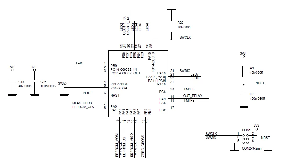

Suggests NRST is being held low. Can you verify with a multimeter?
Likely to be an issue with the board design or assembly, or the wiring between the programmer and the board. Can you share the schematic?
Stastny.Petr
July 28, 2024
All voltages are OK.
This is the schematics:

Sure , that your target is powered ?
st-link seems to get no voltage:
 try connect with mode : normal + software reset .
Stastny.Petr
July 28, 2024
Yes, it is, I tried different kit for programming. Setup is according your recommendation
