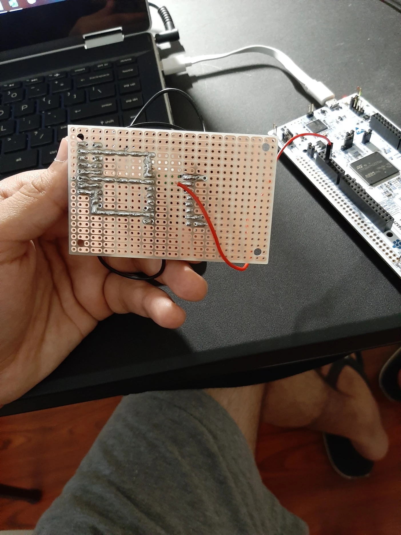

Unable to get QSPI working on STM32F767ZI nucleo and MX25L51245G.
  • July 6, 2020
  • 0 replies
  • 792 views
I am following all the steps mentioned in the QSPI MOOC (https://www.youtube.com/watch?v=XqCq0xtQmbI&t=155s) but the function HAL_QSPI_AutoPolling always gives a TIMEOUT.
I obtained the flash memory drivers from STM public storage ( https://github.com/vlcekji2/External-Loaders). I have soldered a PCB hat and connected the flash to the Nucleo. Please let me know if you have any idea why this is failing.
Can I replace HAL_QSPI_AutoPolling by an acceptable delay if I am okay with it?
Will this affect memory mapping and loading executable on to the external flash?
