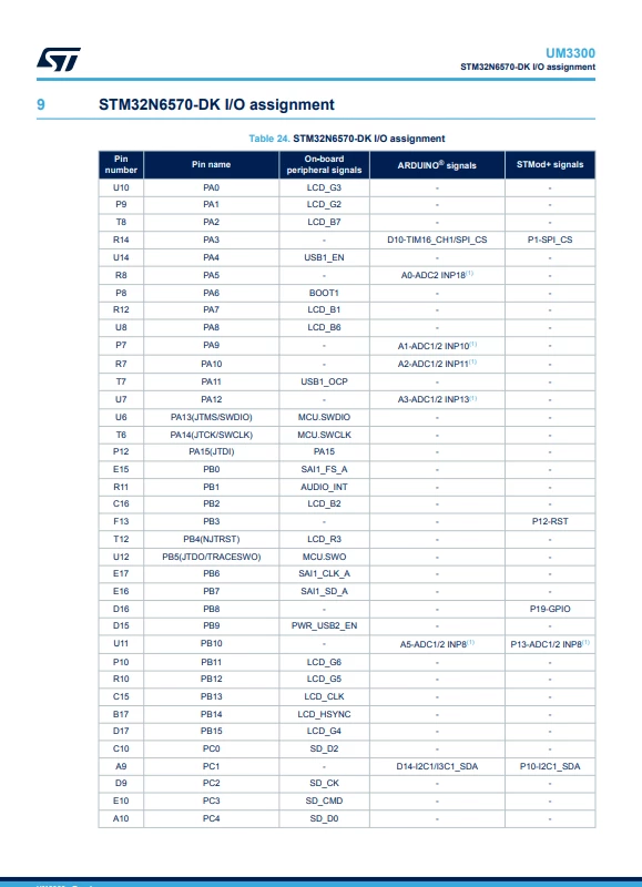

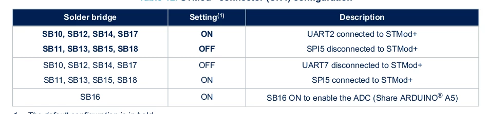

I don't know which is the PB10 pin on the STM package as it has a VFBGA structure and i can't access those pins. But I have checked that SB16 0 ohm resistor is present and it is soldered, which was necessary to enable that ADC.
Jun 11, 2025 12:42 PM UTC

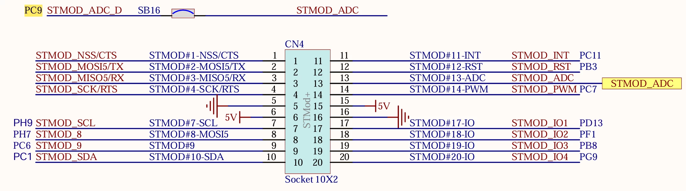

> ADC1/2 INP8 channel (PB10) using the MB1280C Fanout board (Pin 13)
Pin 13 is connected to PC9, not PB10. Or am I missing something?
