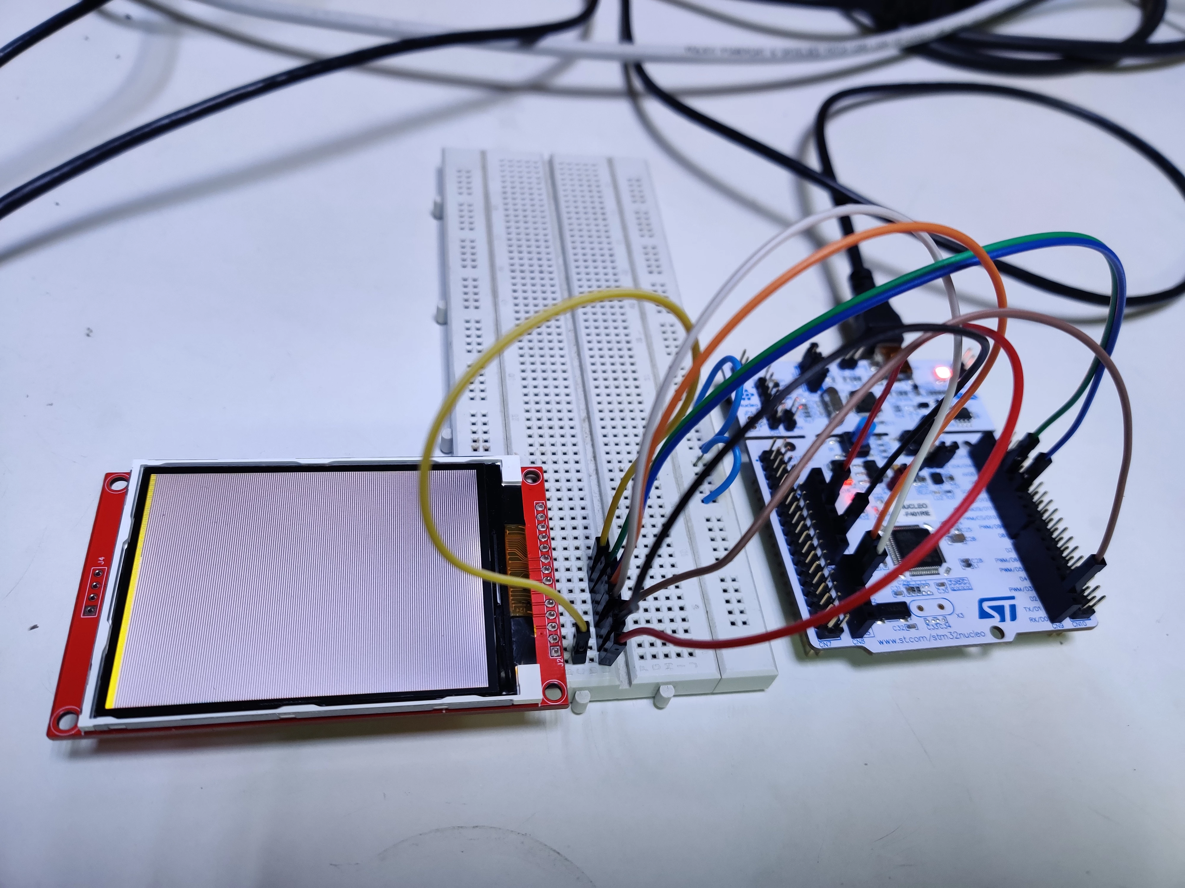

Unable to get a proper display on TFT screen interfaced with NUCLEO-F401RE board.
  • June 22, 2022
  • 0 replies
  • 1145 views
Hello everyone.. After a lot of efforts, I found a working library for 3.2" TFT color LCD display with ILI9341 driver (240x320) which I am interfacing with my Nucleo F401RE development board. I just tried writing a simple "Hello World" code after filling the screen with some color. But as you can see in the attached image, the color is getting filled only on some of the left portion of the screen. Can somebody please tell me what is the problem with it. I have used STMCubeMX with Keil uvision. Following are the interconnections that I made on the hardware side (TFT display and NUCLEO-F401RE board):
PA5 - SPI1_SCK
PA7 - SPI1_MOSI
PA1 - DC
PA4 - RESET
PA2 - CS
3.3V - VCC
GND - GND
3.3 V - LED
The display that I used is:
https://www.xcluma.com/3-2-inch-tft-without-touch-color-spi-serial-interface-lcd-display-module-driver-ili9341
I would be very grateful if somebody helps me solving this issue. Thanks in advance.
