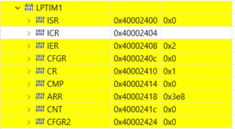

waclawek.jan
March 1, 2022
Please read out and check/post LPTIM registers content.
Arrhenius
ArrheniusAuthor
March 2, 2022
I am attaching the screenshot of LPTIM1 registers.
waclawek.jan
March 2, 2022
CFGR is zero, so your setup (including prescaler setup) apparently does not work.
Check the symbols you are using there; or, better, use consistently symbols from CMSIS-mandated device header.
Also note, that peripheral registers may not be available immediately after peripheral's clock being switched on in RCC, read Clock switches and gating subchapter of RCC chapter in RM.

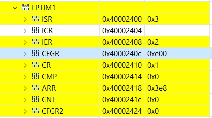

Arrhenius
ArrheniusAuthor
March 2, 2022
CFGR is zero because I was trying out different combinations.
Attached is the updated configuration with DIV/128 Prescaler.
I am using CMSIS header file.
I agree with your point on peripheral registers may not be available immediately, In my case there's sufficient time and that's the reason I am able to write something in the register.
TDKBest answer
March 2, 2022
Seems unlikely that CNT=0 in both examples. If you reload registers, can you see it change value?
> TIMER->ARR = TIMER_PERIOD;
> TIMER->CR |= LPTIM_CR_ENABLE;
You're touching ARR before the counter is enabled, which is not allowed:
Arrhenius
ArrheniusAuthor
March 11, 2022
Hi @TDK​ ,
Yeah you were right. I missed out with the sequence.
I got it working now. Thanks a lot.
