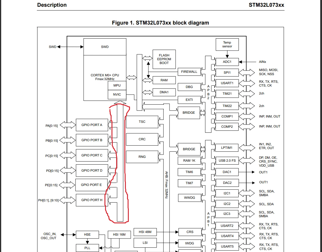

Unable to find Peripheral Bus for GPIO Port for STM32L073RZT6 to enable Clock
Can anyone help me find the Peripheral Bus to enable Clock for the GPIO Port on the STM32L073RZT6 microcontroller? Please find the screenshot attached.ST_Doubt1.png

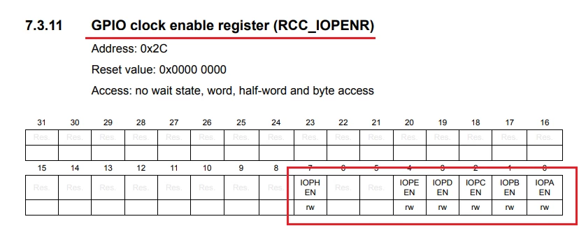

Hello and welcome to the community,
Not sure I understood what do you mean by "the Peripheral Bus to enable Clock for the GPIO Port"
To enable the GPIO port clock you need to do that in RCC:
RM0377 rev / page 196:
