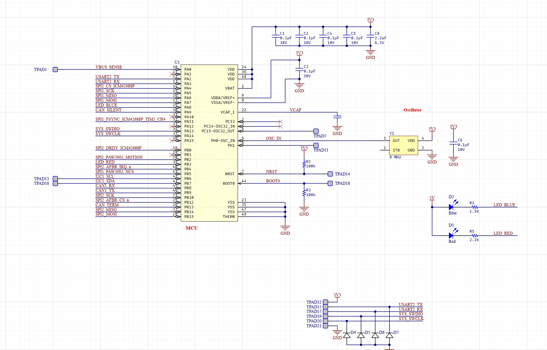

 Here is the circuit.

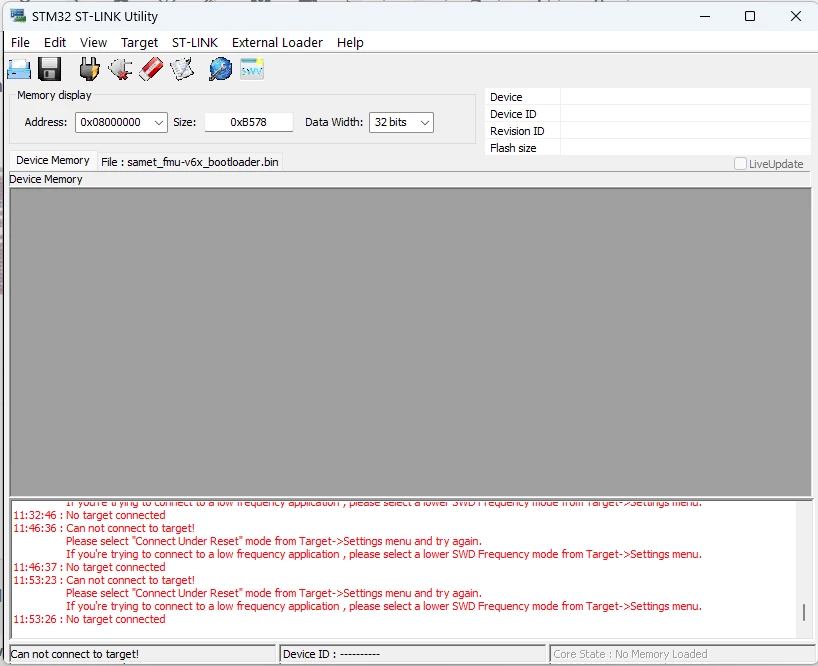

I have tried different settings, still getting the error.
I verified all the voltages and settings. They all seem ok.

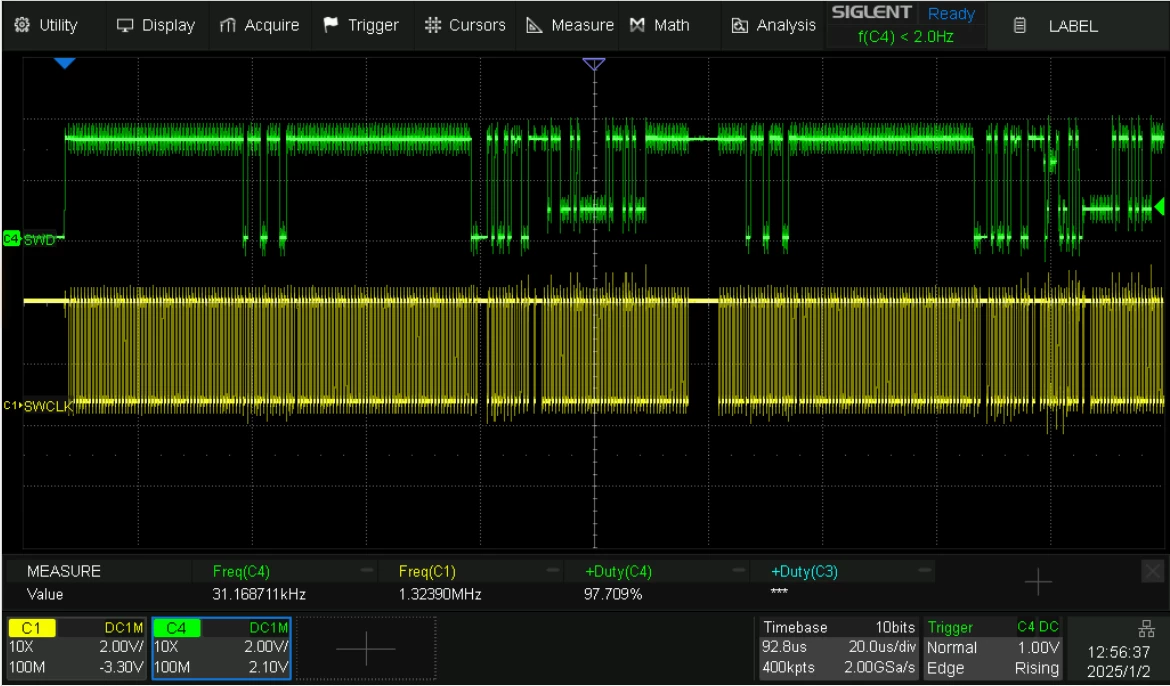

I also measured the signals on SWD.
The only thing is the voltage level on SWD for the 0-V level looks suspicious.
Can anyone help me to find the issue?

I just found the issue. I connected the VDD of the debugger pin to the same voltage of the board, now I can connect to the target.

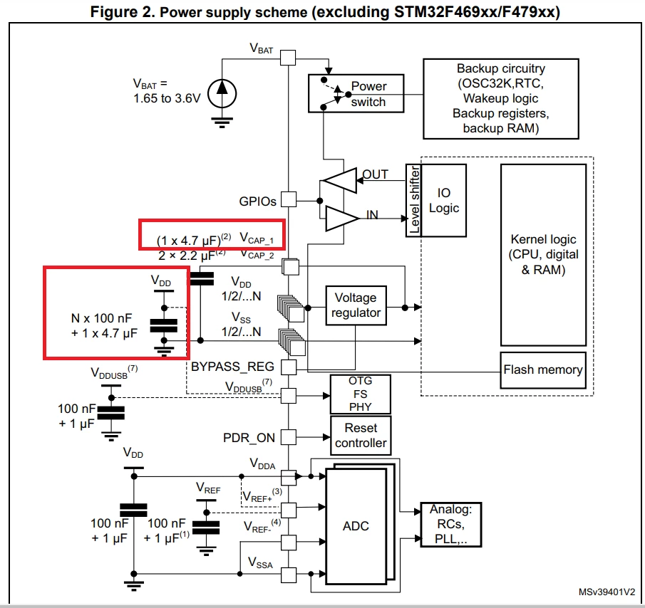

What is the value of the capacitor connected to VCAP pin?
According to the AN4488 "Getting started with STM32F4xxxx MCU hardware development":
1- You need a 4.7uF capacitor on VCAP1 pin.
2- And a 4.7uF as decoupling capacitor connected to VDD not 2.2uF.
PS:
1- No need for NRST pullup resistor, as there is one internal in the chip.
2- Please use STM32CubeProgrammer to connect to the MCU instead of STLINK utility as it's a deprecated tool.
