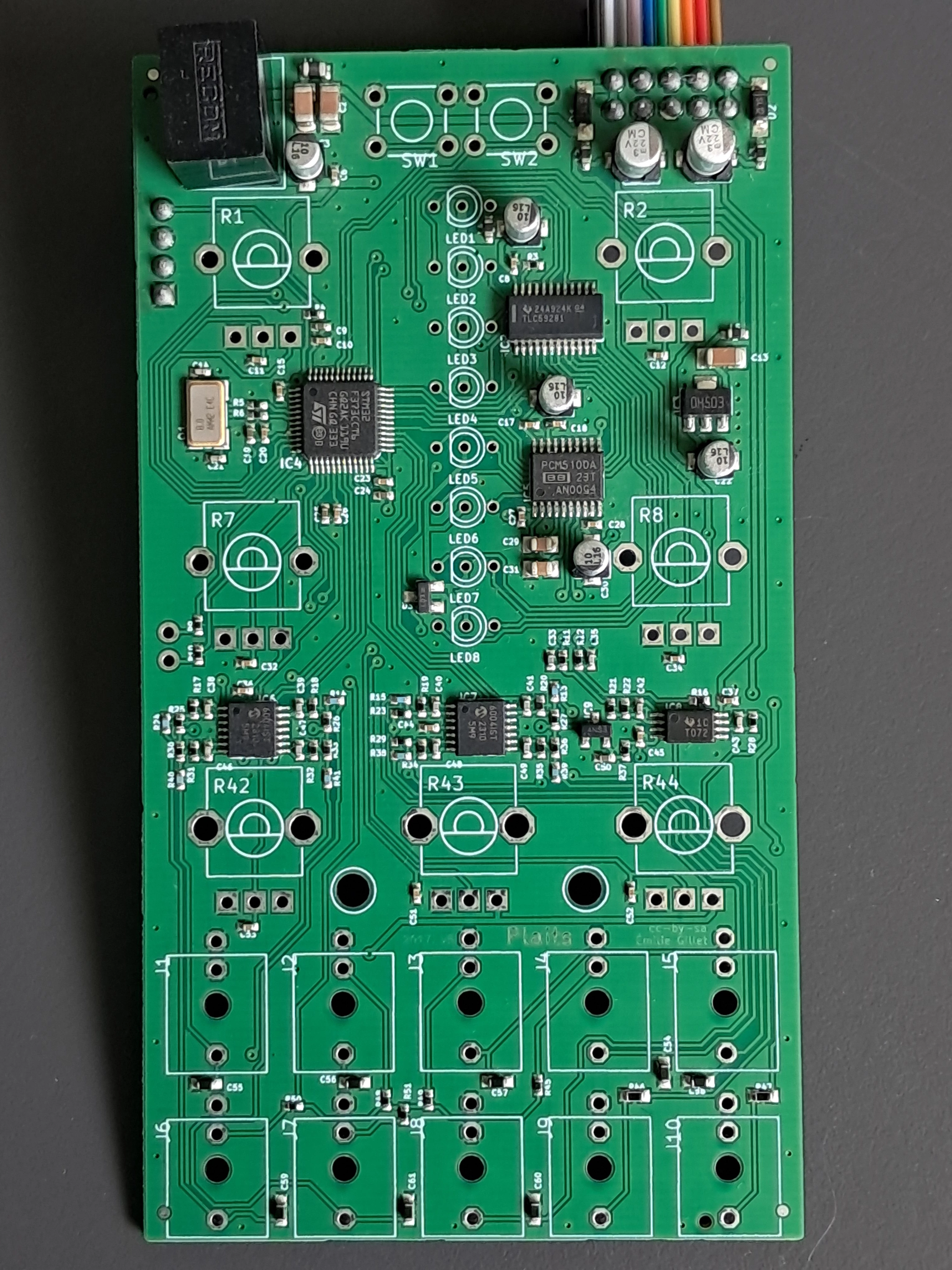

Hi all,

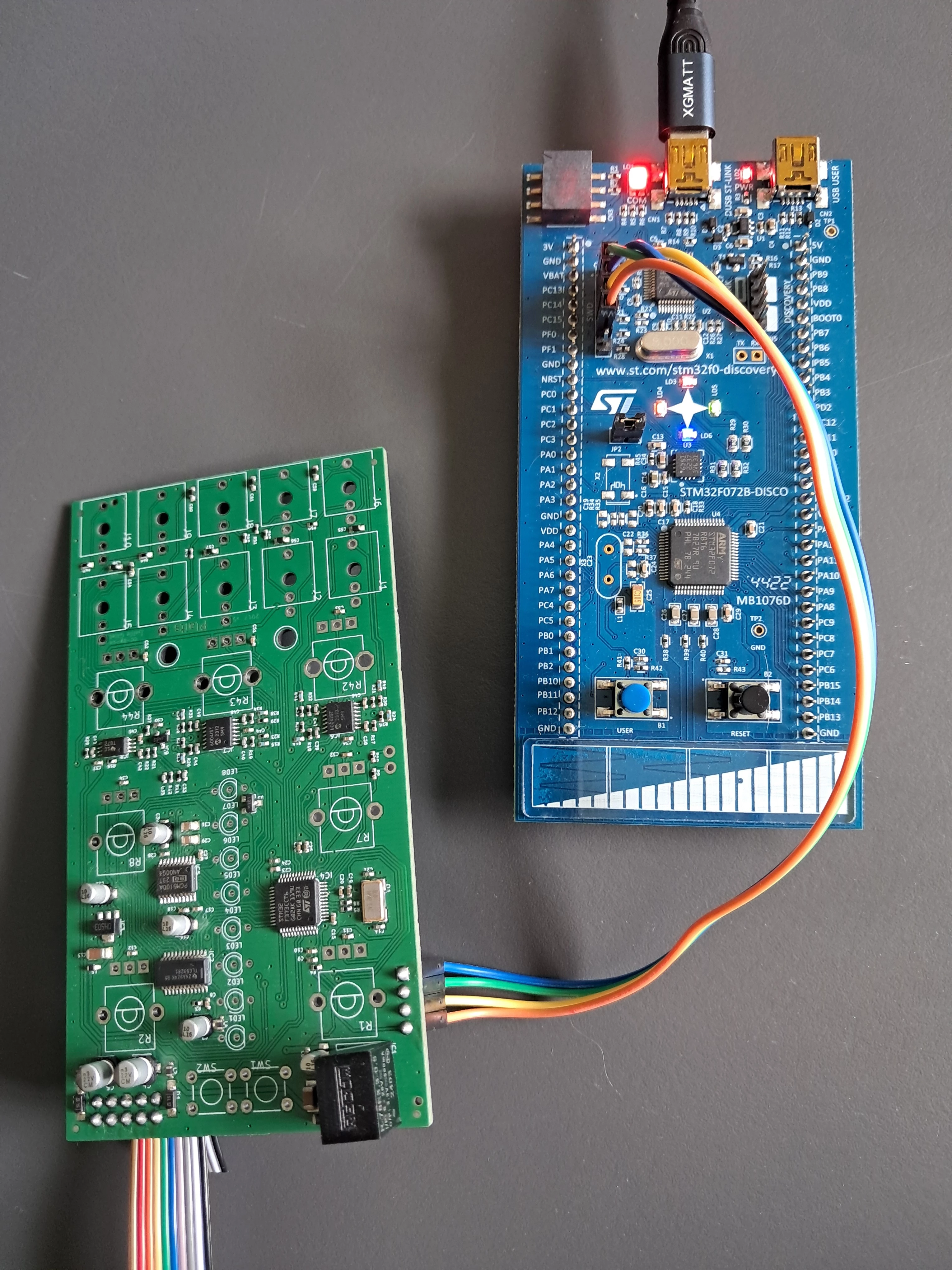

I'm having trouble connecting to an STM32F373C on a custom PCB via STM32CubeProgrammer, using an STM32F072B-Discovery board as a standalone ST-Link/V2. The custom PCB is an open source synthesiser module and was manufactured by JLCPCB - many others have built this PCB with no issues. I've followed the correct procedure for using the Discovery board as an external ST-Link (removed CN5 jumpers, opened SB10), and wired CN4 to my PCB's dedicated SWD header which has RESET, SWCLK, SWDIO and GND pins.
**Setup:**
- Programmer: STM32F072B-Discovery (ST-Link/V2), CN5 jumpers removed, SB10 opened
- Target: STM32F373C on custom PCB
- Connection: Via dedicated SWD header (RESET, SWCLK, SWDIO, GND). Discovery board connected to Macbook using Mini USB to USB C cable.
- Software: STM32CubeProgrammer, SWD mode, various frequencies tried down to 480 kHz
- Reset modes tried: Software reset, Hardware reset, Connect under reset

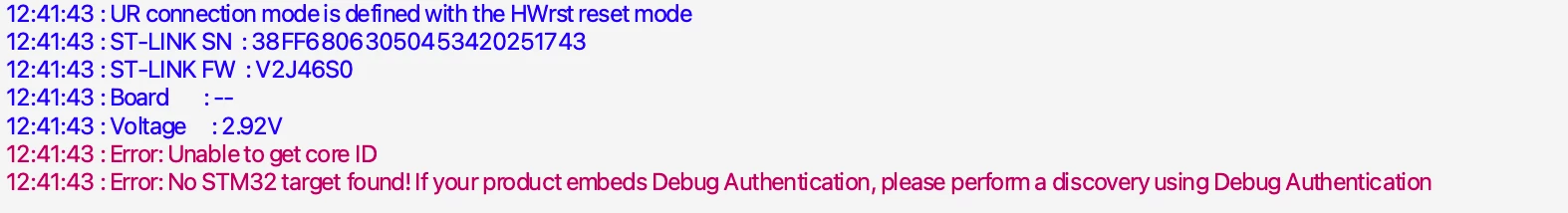

**Error in CubeProgrammer:**
ST-LINK SN: 38FF68063050453420251743
ST-LINK FW: V2J46S0
Voltage: 2.92V
Error: Unable to get core ID
Error: No STM32 target found

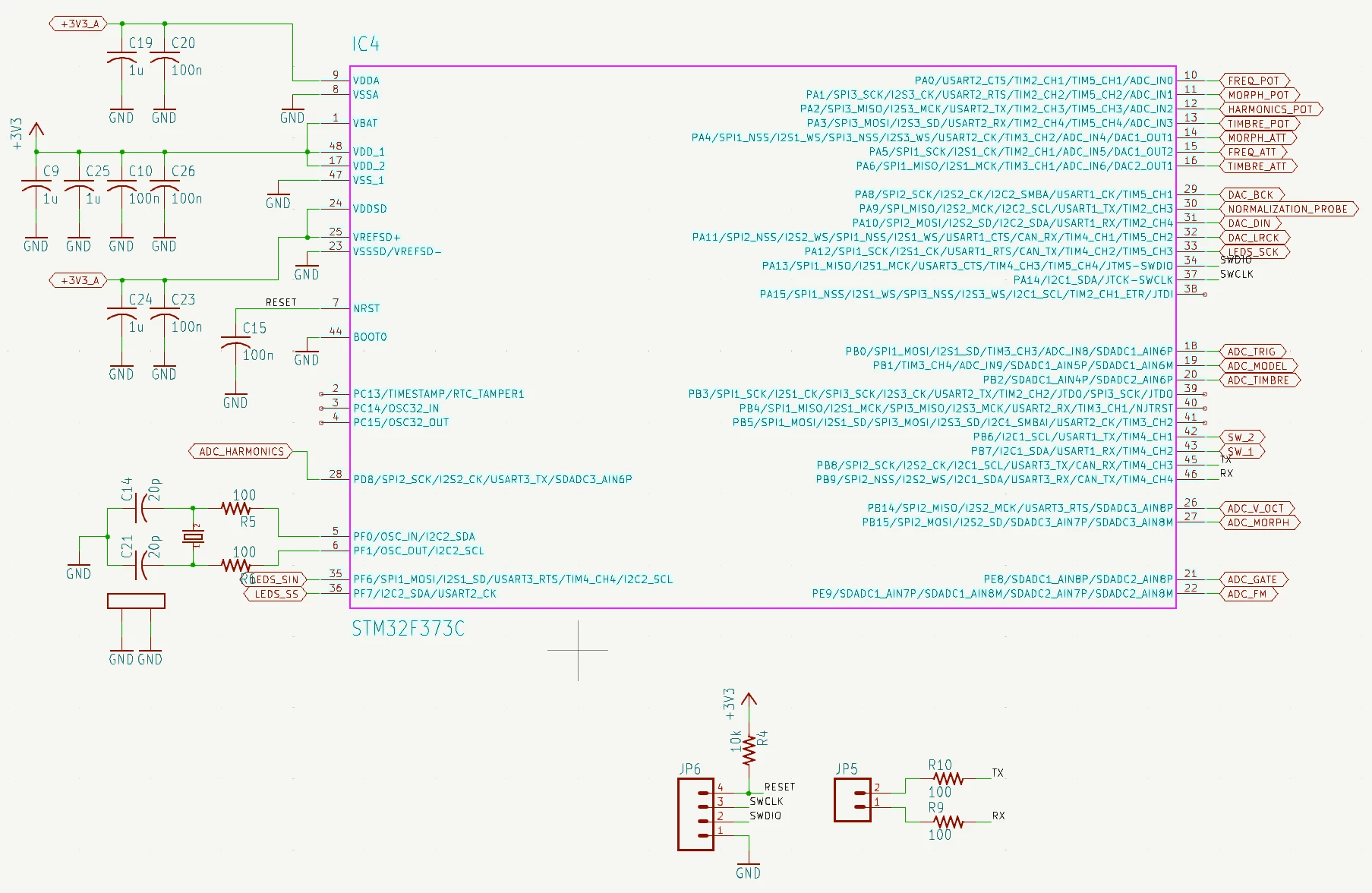

**Power supply.**
- VDD, VDDA, VBAT, VDDSD and VREFSD+ pins on the STM32 have been probed and confirmed at 3.3V.
**BOOT0:** Pulled directly to GND.

I have attached pictures of the STM32CubeProgrammer error, PCB schematic, physical PCB and the ST Link connection.
Are there any other pins I should read voltages from? Are there any components I may have incorrectly ordered or orientated which could be causing the problem? The PCB should in theory work as it was once mass produced, I haven’t modified the design, and many others have had it manufactured with no issues.
Thanks

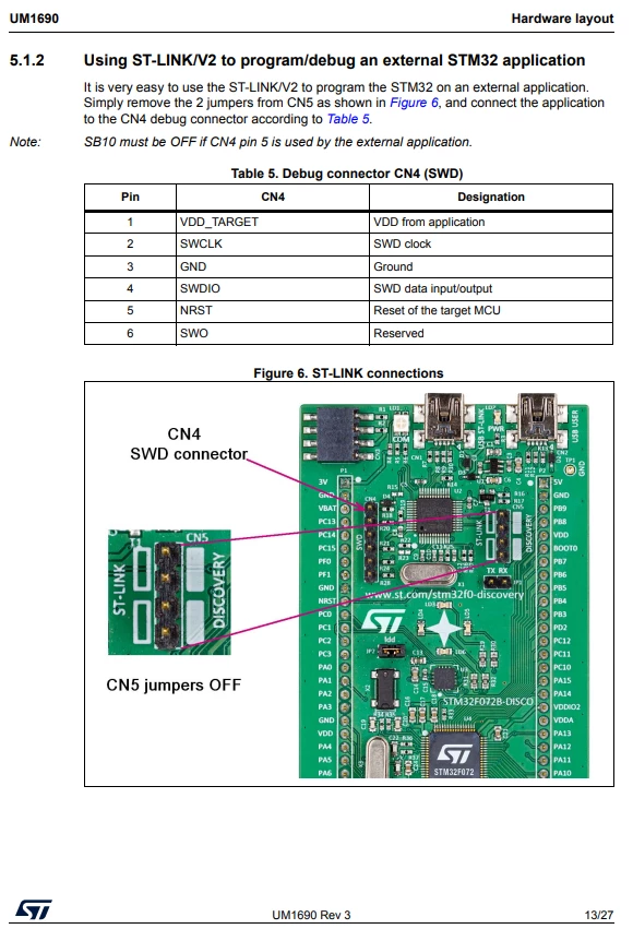

Did you follow carefully the User Manual instructions - particularly about SB10:
https://www.st.com/resource/en/user_manual/um1690-discovery-kit-for-stm32f0-series-microcontrollers-with-stm32f072rb-stmicroelectronics.pdf#page=13
via: https://www.st.com/en/evaluation-tools/32f072bdiscovery.html#documentation
While it should be possible to use the Disco board as an STLink, this does come with a few issues which complicate things.

Sorry, I missed this bit:
But you do seem to have omitted the VDD_TARGET connection.
Are you sure you have the pin numbering correct, and the wiring correct to the target?

Jun 22, 2026 4:11 PM UTC
Yes I have followed the instructions in the User Manual. The SWD connector is wired up correctly, I have removed the jumper from CN5 and I have removed the solder bridge from SB10 in order to use the NRST pin (confirmed with a multimeter).
I have tried connecting VDD_TARGET to the 3.3v rail on the PCB using one of the empty through hole part pads.
I have confirmed 3.3v is being supplied to VDD, VDDA, VBAT, VDDSD and VREFSD+ on the STM32.
Are there any other volatages on the STM32 you would recommend testing?
I have already tried a standalone STLink, albeit a clone. This gave me the same "target not found" error, so I purchased the discovery board which the original manufacturer recommends to flash the STM32.
I will try a genuine standalone STLink if there is no obvious troubleshooting I can try first. What was supposed to be a DIY project to save some money is turning into quite an expensive endeavour!

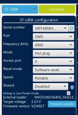

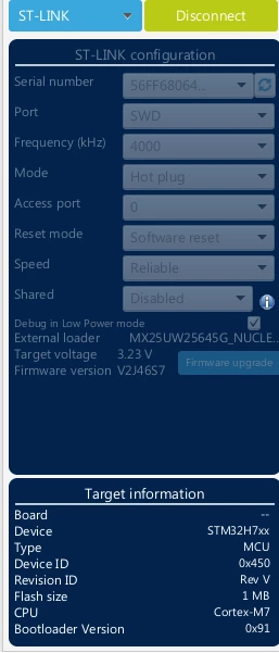

AScha.3
Jun 22, 2026 4:29 PM UTC
As you have not connected rst, only setting “software reset” will work.
Try with the “clone” , stick, and verify swd + swc , not puzzled.
With CubeProgrammer it looks like this:
...and after : connect :
Show, what its telling.
btw I use V. 2.19.0 , maybe try this version.
