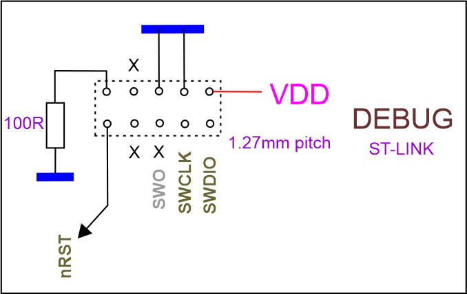

What is the header pinout for your debugger?
The debugger wants to see the VDD of the target: if you do not provide VDD on debug header - the debugger might "think": "there is not a target connected. And debugger needs also VDD from target in order to "adapt" the debug voltage levels. Without VDD to debugger - it fails.
My debug header for ST-LINK looks like this:
If the debugger does not find VDD (or the GND via this 100R) - it might assume the target is not connected.
