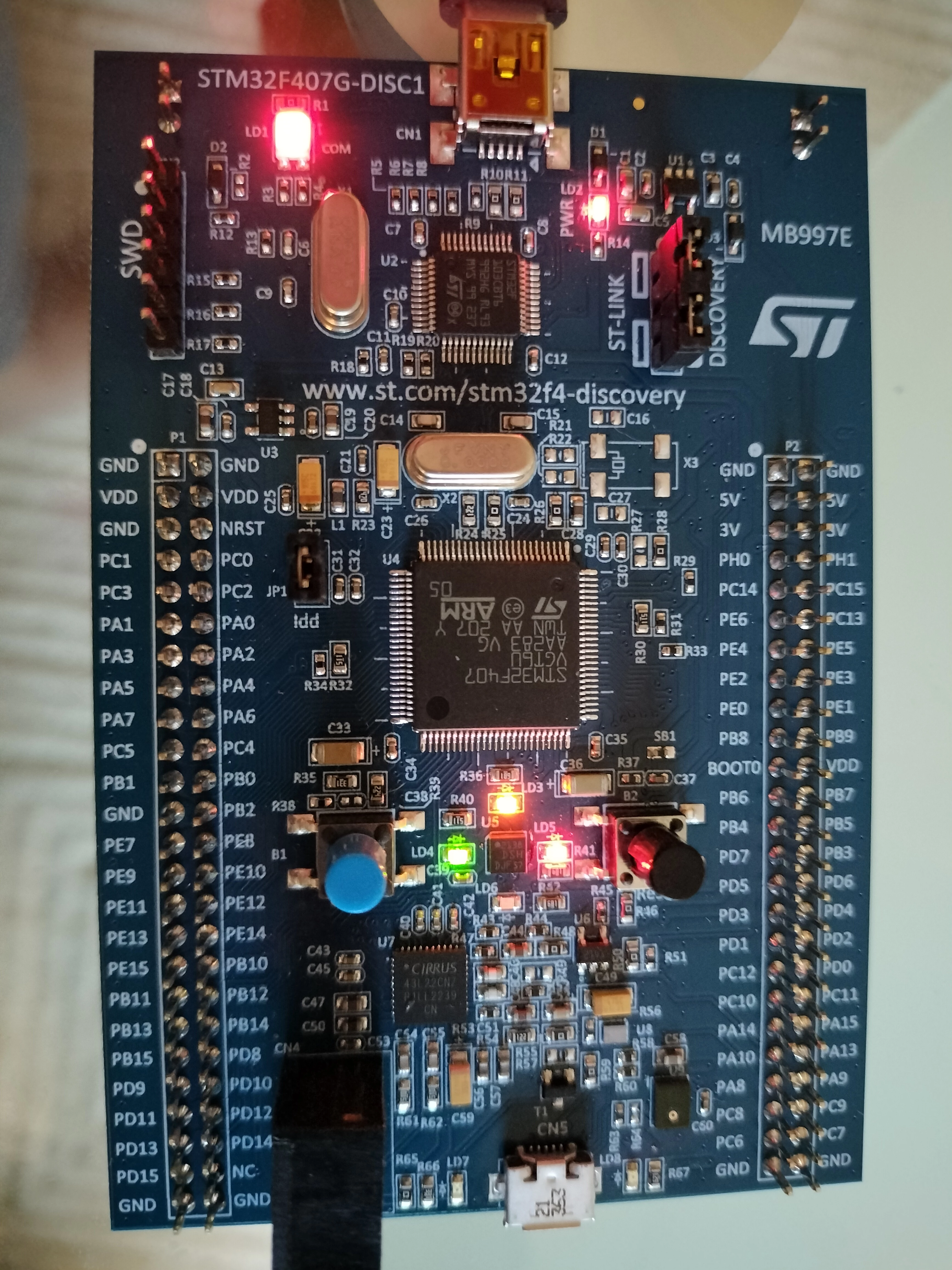

Hello there
Just tried connecting my STM32F4DISCOVERY board to my PC. It appears that the underlying operating system recognizes the driver/device correctly. I've tried this on both Windows 10 and Linux and this seems to be the case on both.

And this is what I see on STM32CubeProgrammer:
18:40:56 : STM32CubeProgrammer API v2.17.0 | Linux-64Bits
18:40:56 : ST-LINK error (DEV_CONNECT_ERR)
I'm at my wit's end trying to get this connected to my PC. The exact same message is seen on STM32CubeProgrammer on a windows machine. Of course the windows kernel log would change.
The board is currently running the demonstration firmware that toggles the LEDs in a circular manner for 8 times then it toggles them all together. I'm attaching the pic. I've scraped the web looking for a way to get this connected but they suggest resetting the board via the STM32CubeProgrammer but for this to work, it has to be detected by it. So im in a catch 22 kind of situation here.

Hello @WhackedDoon711 ,
You can try resetting the device when the BOOT0 pin is HIGH.
Do you have the target interface set to SWD?
August 20, 2024
Hi Imen
Could you please elaborate? I haven't made any jumper modification as such since the board arrived. About the SWD, what is that and how do I check that? Sorry for being a noob. Im an embedded noob as such
