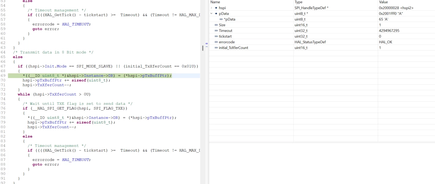

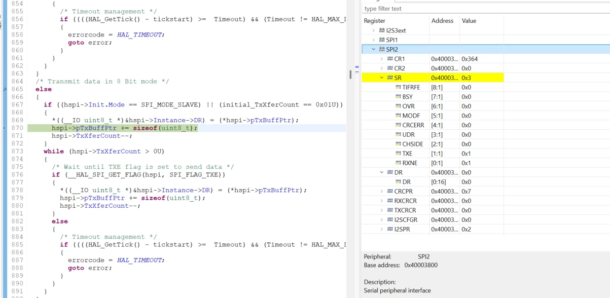

January 16, 2025
@gbm I have tried capturing variable using debugger after fixing compilation error ,still same issue and found that DR register not updating its value to 0x41

Don't inspect the registers like this, it's invasive, reading DR clears bits in SR. It will also break FIFOs on models that have those.
Also DR is TWO registers at the same address, the data you write in there is NOT the data it reads back.
It's not a MEMORY cell, its a view on a more abstract and complex logic structure, if you looped back the MOSI to MISO you'd need to clock 8 times to see the same data returned on the input side.

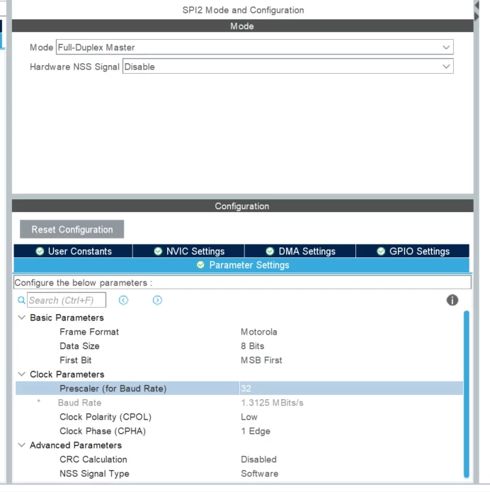

// This Master SPI setting generated based on CubeMX IDE which sets CS to SPI_NSS_SOFT Mode
 void MX_SPI2_Init(void)
 /* USER CODE BEGIN SPI2_Init 0 */
 /* USER CODE END SPI2_Init 0 */
 /* USER CODE BEGIN SPI2_Init 1 */
 /* USER CODE END SPI2_Init 1 */
 /* SPI2 parameter configuration*/
 hspi2.Instance = SPI2;
 hspi2.Init.Mode = SPI_MODE_MASTER;
 hspi2.Init.Direction = SPI_DIRECTION_2LINES;
 hspi2.Init.DataSize = SPI_DATASIZE_8BIT;
 hspi2.Init.CLKPolarity = SPI_POLARITY_LOW;
 hspi2.Init.CLKPhase = SPI_PHASE_1EDGE;
 hspi2.Init.NSS = SPI_NSS_SOFT;
 hspi2.Init.BaudRatePrescaler = SPI_BAUDRATEPRESCALER_32;
 hspi2.Init.FirstBit = SPI_FIRSTBIT_MSB;
 hspi2.Init.TIMode = SPI_TIMODE_DISABLE;
 hspi2.Init.CRCCalculation = SPI_CRCCALCULATION_DISABLE;
 hspi2.Init.CRCPolynomial = 10;

-> SPI Baud Rate = 1.3125 Mbps
-> Full-Duplex Master
-> Hardware control CS : Disabled

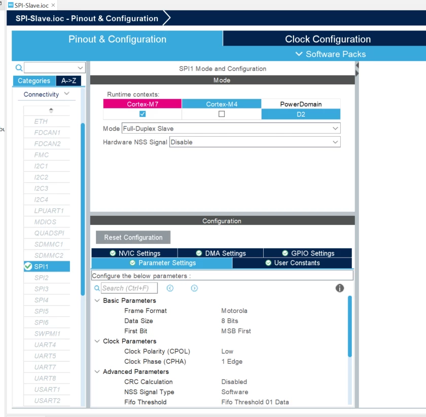

# Slave

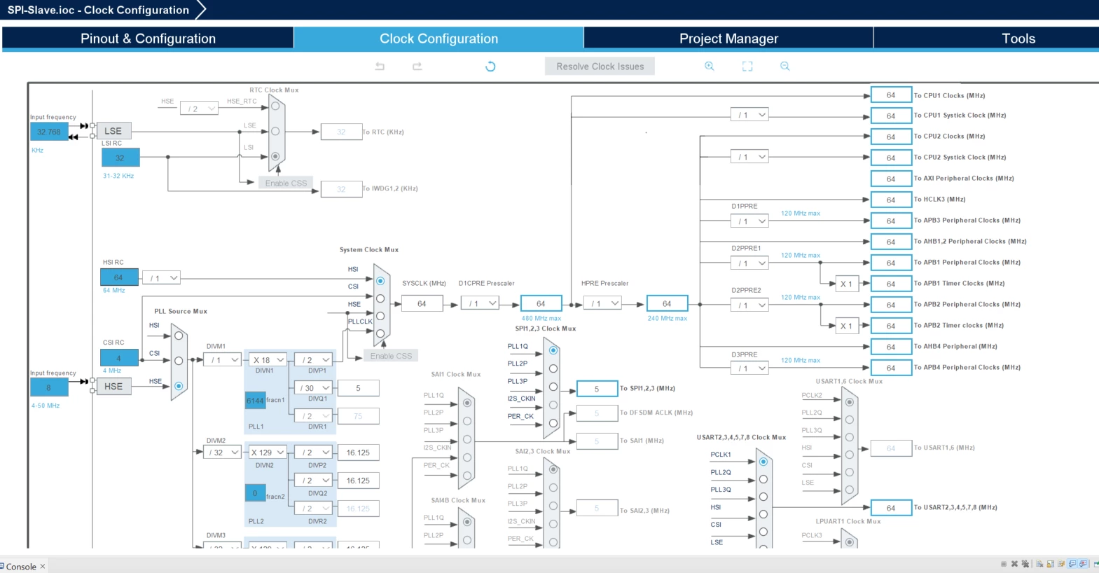

-> Slave Peripheral Clock Frequency: 5Mz
-> Full-Duplex Slave
