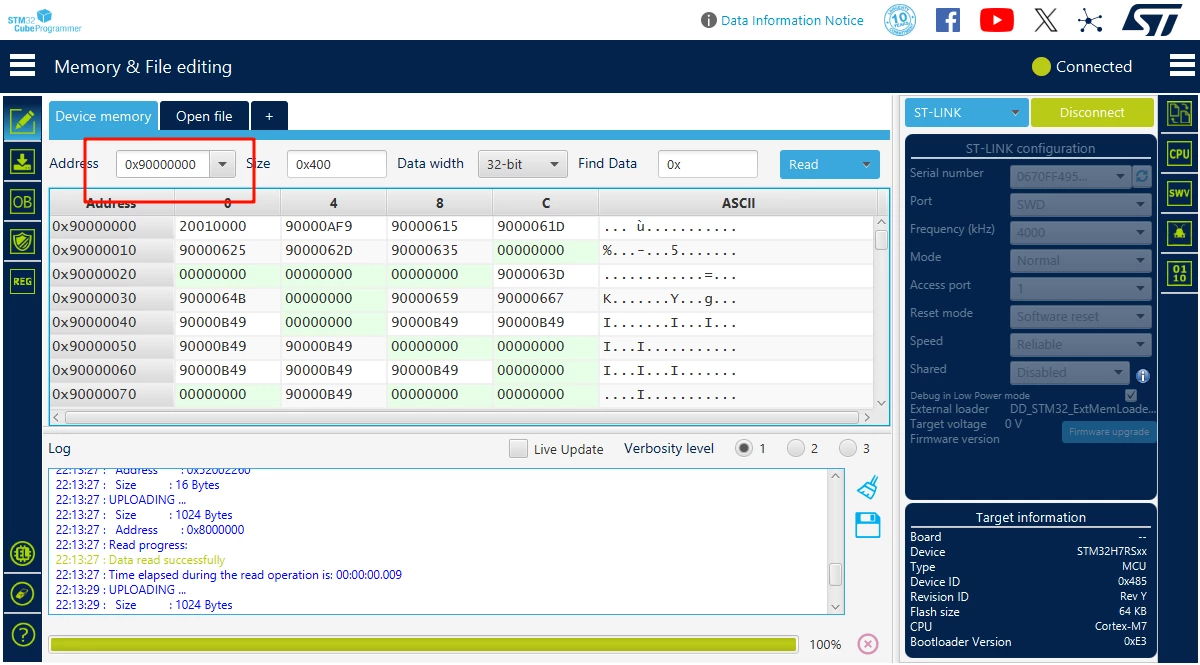

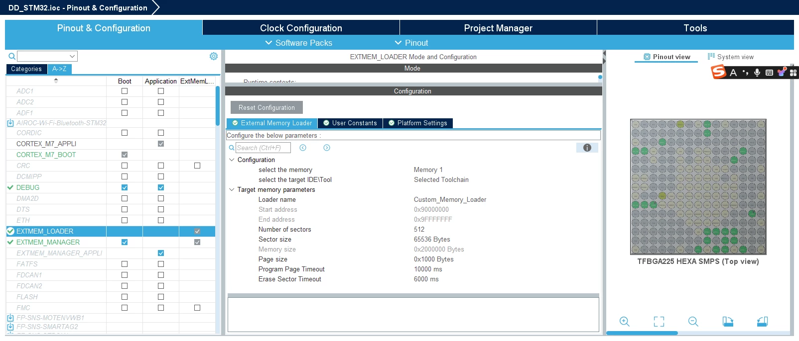

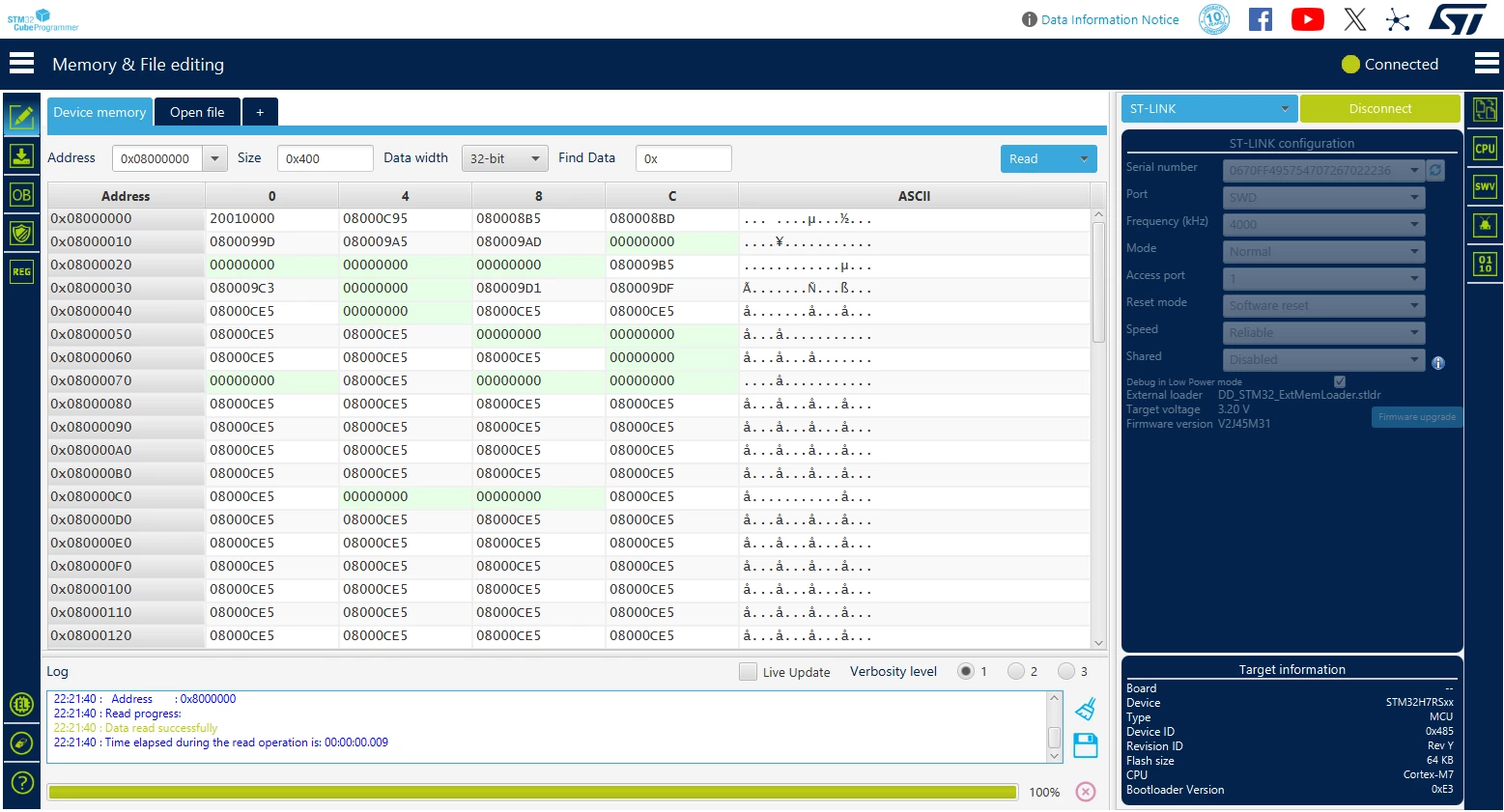

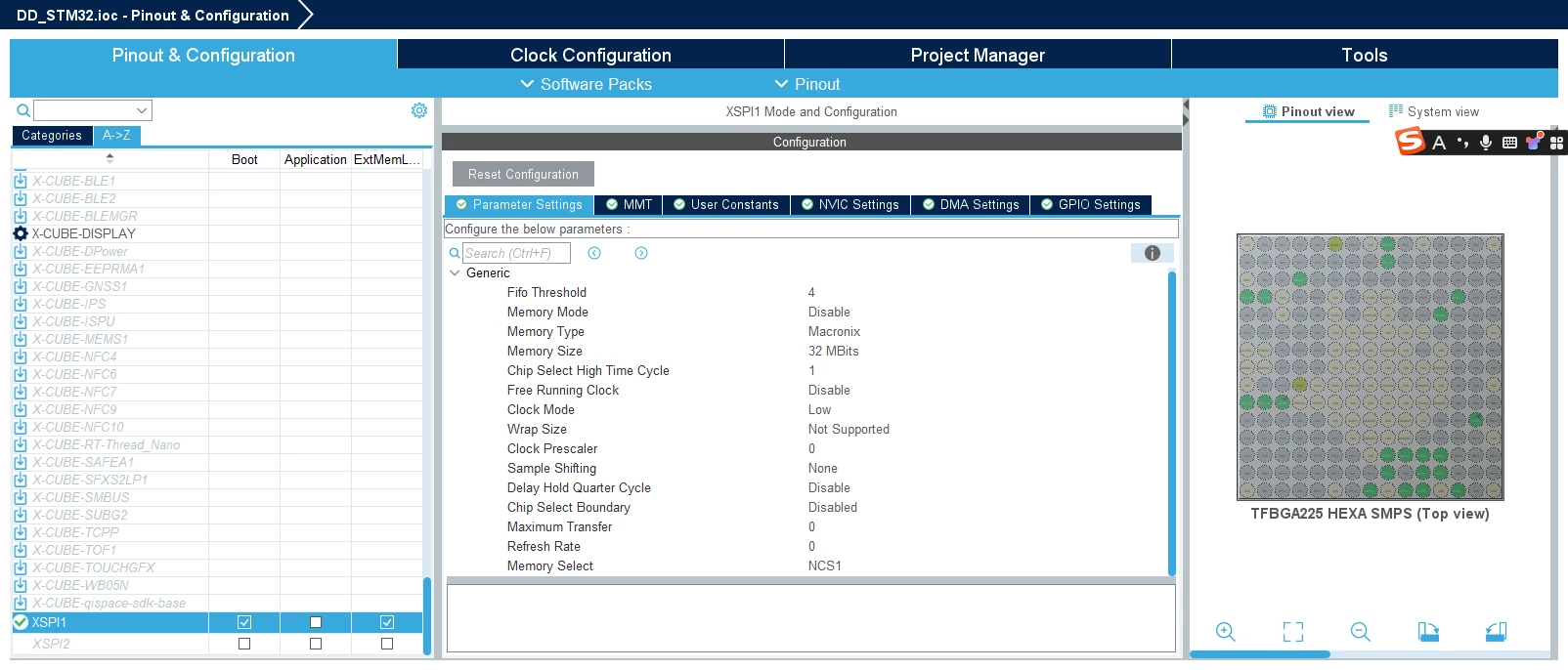

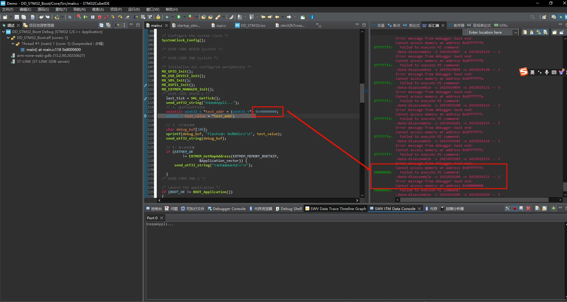

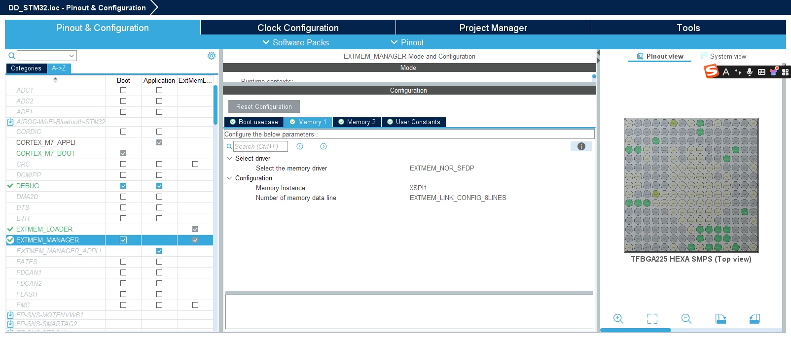

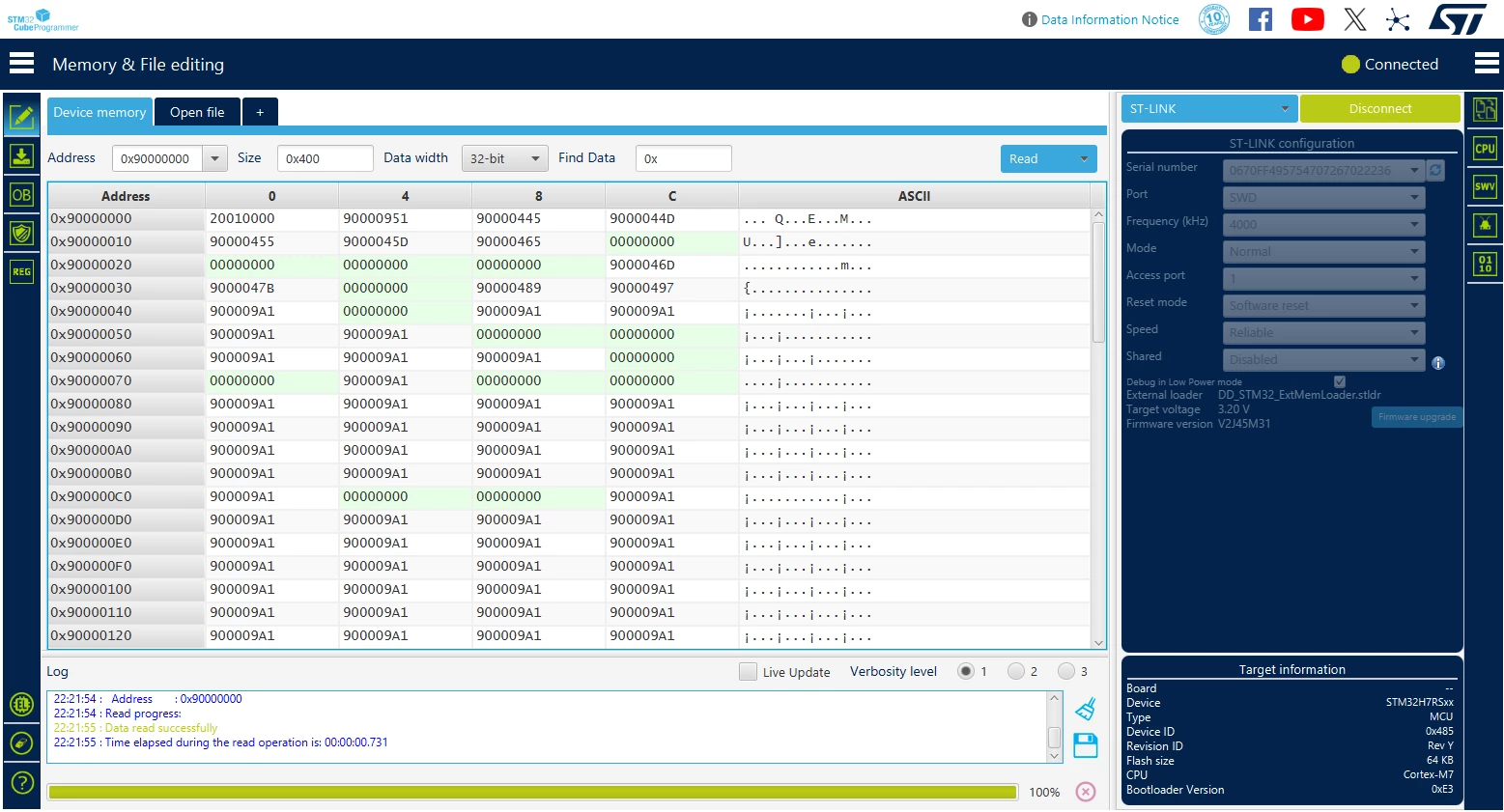

The application can be downloaded to external Flash at address 0x90000000. However, during debug startup, address 0x90000000 cannot be accessed, even though there are no errors during XSPI initialization.

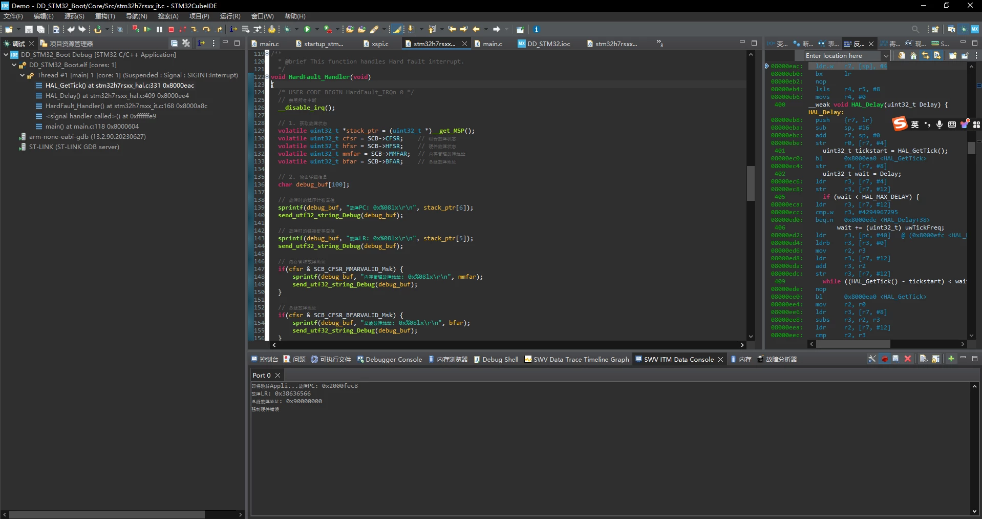

Hardware Error:
  • Fault PC (Program Counter): 0x2000fec8
  • Fault LR (Link Register): 0x38636566
  • Bus Fault Address: 0x90000000

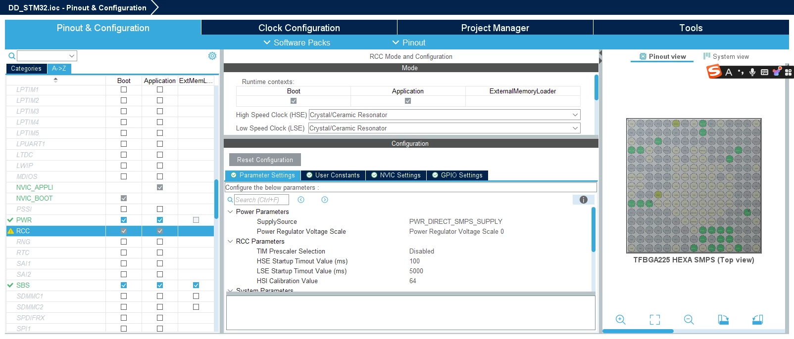

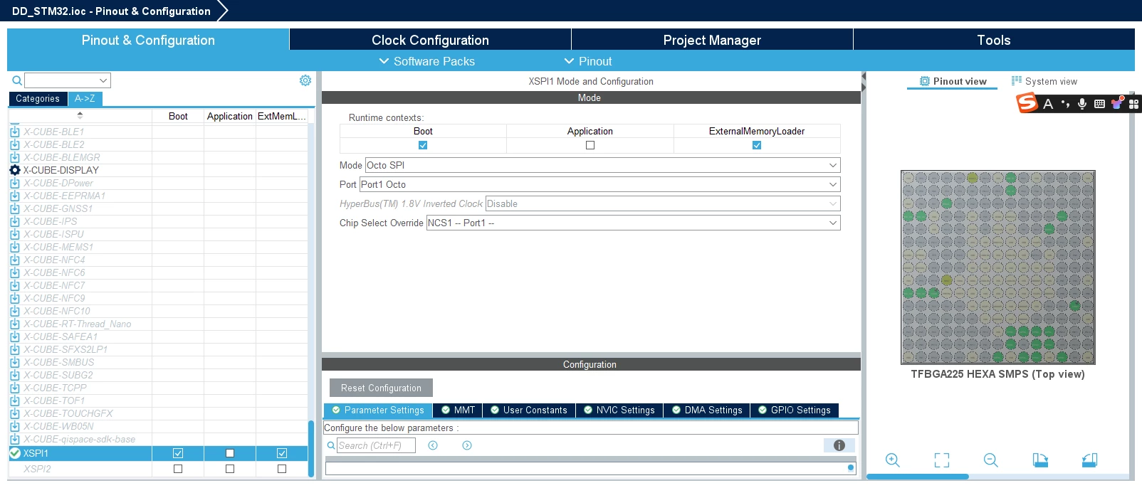

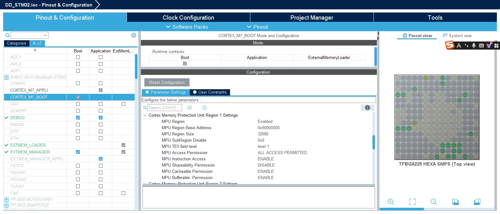

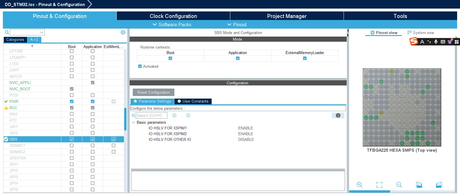

Hard Fault Error The flash chip is: MX25UM25645G Set as follows AMOMO_0-1735396099632.pngAMOMO_1-1735396107943.pngAMOMO_2-1735396113323.pngAMOMO_3-1735396128935.pngAMOMO_4-1735396135509.pngAMOMO_5-1735396147134.pngAMOMO_6-1735396154570.png

LR looks to be ASCII junk, perhaps popped off the stack.
You'll need to look at the generated CODE, and debug it

AMOMOAuthor
Dec 29, 2024 2:25 PM UTC
After adjustments, it seems that the internal flash and external flash structures are similar, but I still cannot access the address 0x90000000. Could you provide tutorials or documentation on how boot accesses flash content? Thank you very much.
