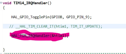

Hi all,
I tried to configure timer 14 to generate interrupt every 500 ms . i am toggling an GPIO to measure delay .
when put a breakpoint interrupt gets triggered but unable to see waveform in logic analyser of GPIO toggling with delay .
My clock frequency is 4 MHZ , desired interval period is 500 ms  so PSC is 2000 , ARR is 1000.
Kindly give suggestions

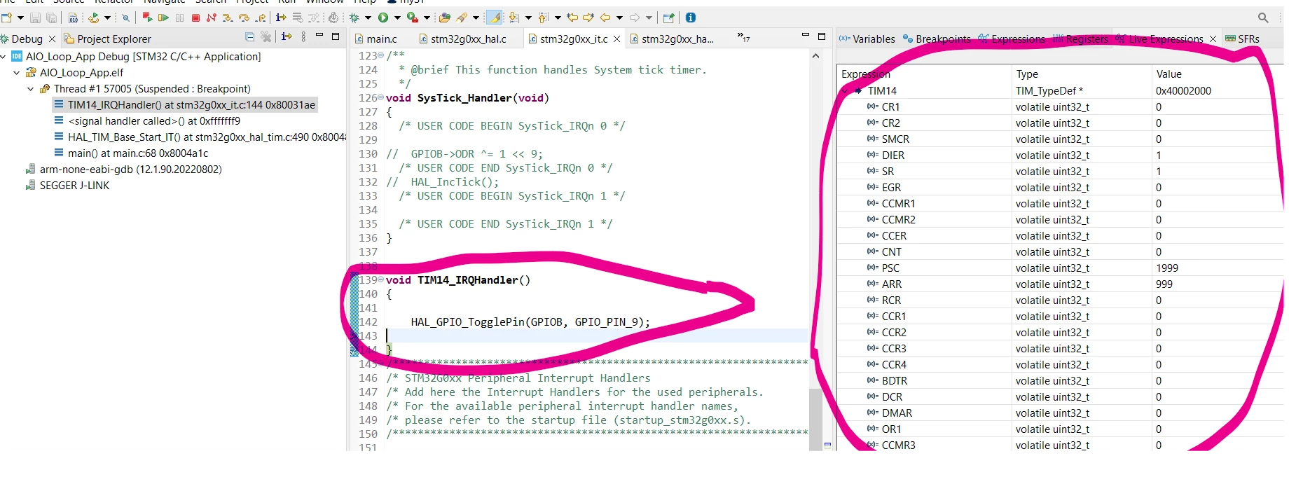

- how do you set the GPIO pin? Read out and check the GPIO registers content
- I wonder how comes you see interrupts in debugger, since you do not enable any interrupt in timer - read out and check TIM_DIER register content
- in the ISR, you have to clear the source of interrupt
Try not to mix Cube/HAL and register-oriented access.

Hi @waclawek.jan
-> Timer started working now after enabling systick timer base
->I have enabled TIMx_ DIER . kindly check the below
-> Now issue is solved after clearing the interrupts
Thank you
