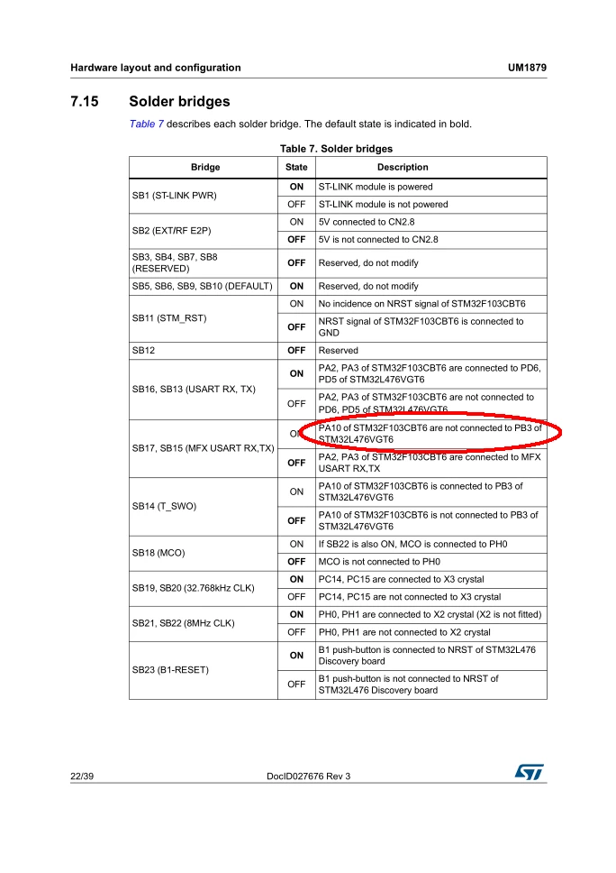

[UM1879 32L476GDISCOVERY manual] jumpers table
Posted on February 25, 2018 at 14:30
Obviously a copy-paste error.
    Imen.DBest answer
    May 22, 2018 11:05 AM UTC
    Posted on May 22, 2018 at 13:05
    We confirm that this line in the table 7 of UM1879 Rev 3 is not correct.
    It will be corrected in next revision of the document as followed:
    SB17, SB15 (MFX USART RX,TX)
    ON
    PA2, PA3 of STM32F103CBT6 are connected to MFX USART RX,TX
    OFF
    PA2, PA3 of STM32F103CBT6 are not connected to MFX USART RX,TX
    Best Regards,
    Imen

    Mar 16, 2018 3:50 PM UTC
    Posted on March 16, 2018 at 16:50
    Hello
    Waclawek.Jan
    This typos is raised internally.
    Thanks
    Imen

    I see UM1879 is in rev.4 now, with the correction as above.
    Pity a complete pinout table (as in the F4 DISCO, as I mentioned above) did not make it into UM1879.
