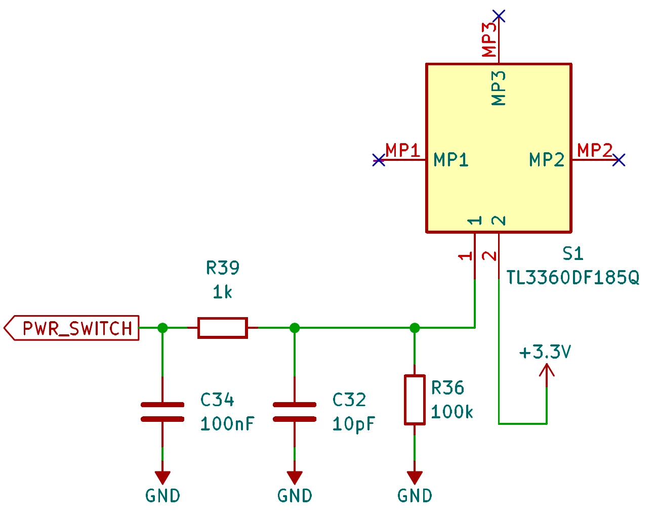

1. The WKUP2 pin currently uses the 3.3V from the buck-boost converter (I copied the same circuit used on the Nucleo develpment board).  But if I disable the buck-boost converter then there will be no 3.3V supply to the switch for the WKUP pin, so the STM32 would never wake.  The circuit is shown below..
2. The battery is 1S so could be up to 4.2V, but the VBAT pin can only handle voltatges of 1.55 to 3.6 V.  So how do I power the VBAT pin using the 1S battery ?
At the moment the current draw In shutdown is around 0.5mA (probably due to the buck-boost converter always running), but I believe if I can disable the buck-boost converter and use the VBAT pin then this could potentially reduce to tens of nA which would make a significant power saving, so I am very keen to implement this if I can resolve the above issues.

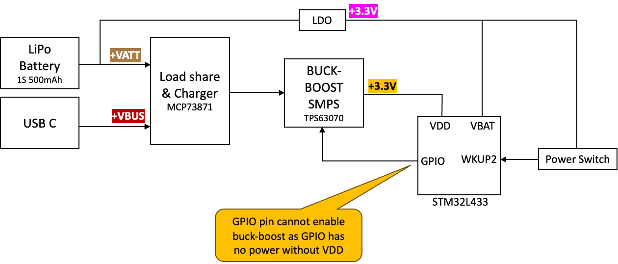

This is the issue I have, its a chicen and egg situtation
To enable the 3.3V buck-boost converter, the STM32 needs to set the GPIO pin high.
However, if the STM32 is only powered by the VBAT pin, then the GPIO pins are not powered so the buck-boost converter cannot be enabled.

I have just implemented the following circuit so I can disable the 3.3V buck-boost converter...
When the button switch is pressed....
  • The 3.3V buck-boost converter is enabled
  • The STM32 is woken
  • The STM32 power hold pin is set high
    • This is to keep the 3.3V buck-boost converter enabled when the push button is released
During shutdown/standby....
  • The 3.3V buck-boost converter is disabled
  • The STM32 VBAT pin is powered by the 1.8V LDO regulator
I had to use a regulator and diode that I had lying around, so there are probably more low power versions I can use, but I just wanted to check the method works.
The current in shutdown has dropped to 33uA (still high but better than 500uA).
But after first testing I have found it has had a knock on effect, such as...
  • RTC wake no longer works (it should wake every 30 seconds, measure a sensor reading and then standby)
  • To put the the firmware into a programming mode, the push button switch has to be held for 5 seconds.  But this no longer works for some reason (maybe 1.8V is not being seen as a logic high, but then it wakes the STM32 via the WKUP pin so it must be something else ?)
  • When debugging (with STLINK) the connection is lost as soon as the 3.3V buck-boost converter is disabled.  This could be a simple fix by using a debug firmware version that keeps the 3.3V buck-boost converter enabled
  • Reading from external flash (W25Q) at power up seems to be intermittent so needs investigating
