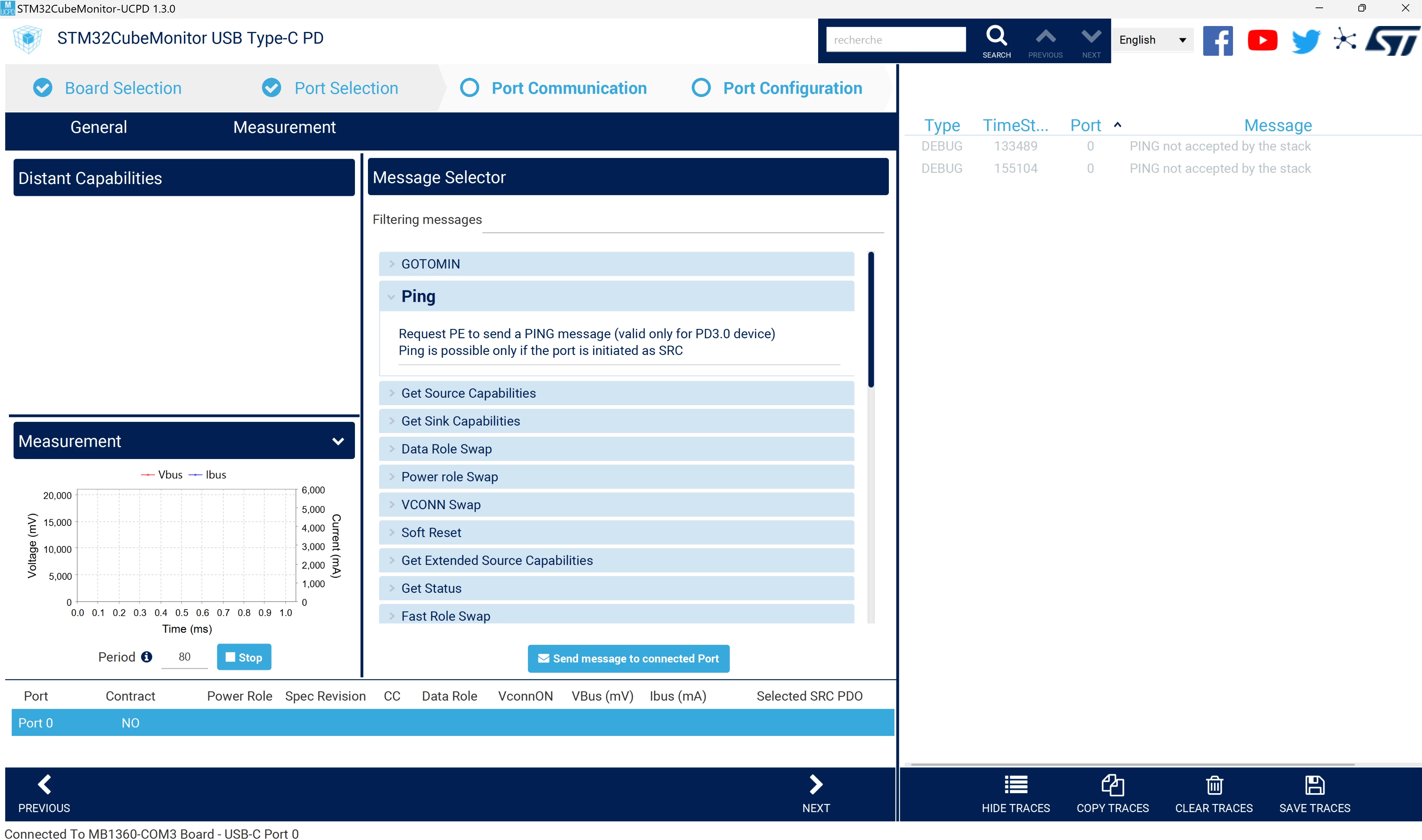

I'm trying to run a simple UCPD SINK application on the NUCLEO-U575ZI-Q.
I attempted to follow the example provided here:
https://wiki.stmicroelectronics.cn/stm32mcu/wiki/STM32StepByStep:Getting_started_with_USB-Power_Delivery_Sink#-5BOPTIONAL-5D_Configure_Tracer_for_debug
With debug setup and everything:
If I allow the application to remain a FreeRTOS application the device does not at all get recognized in STM32CubeMonitor-UCPD.

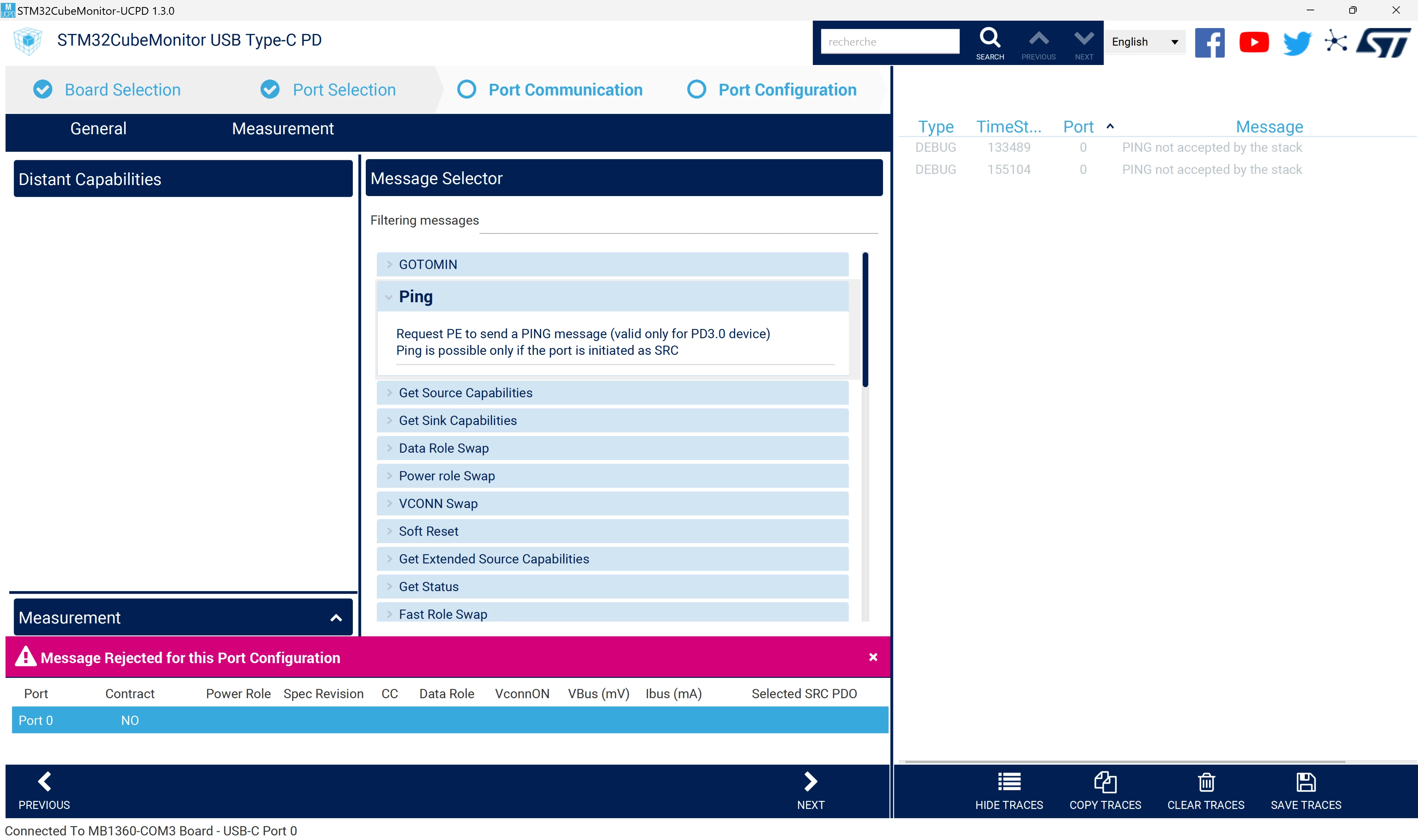

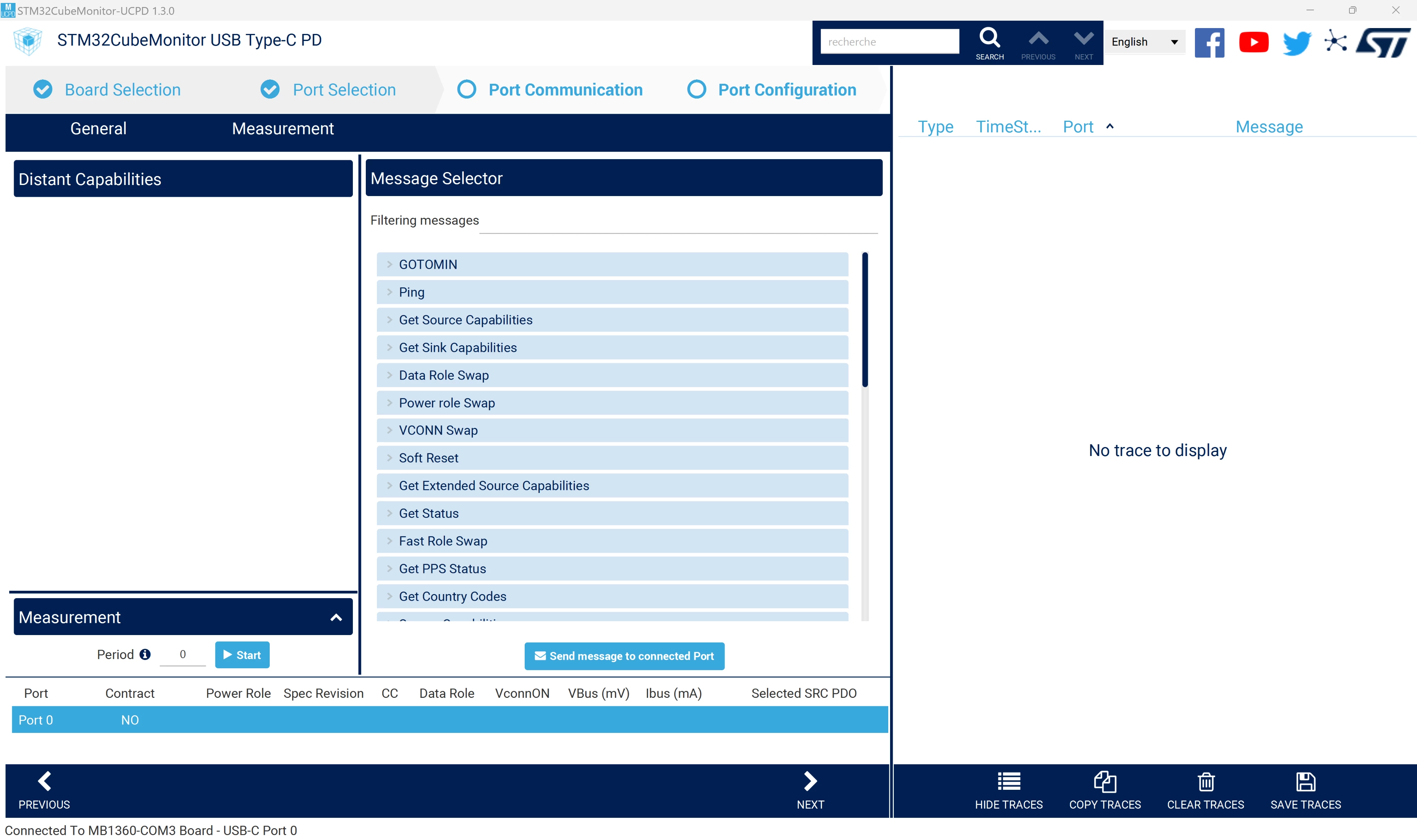

I can connect to the device but I get no trace visibility:
And I cannot communicate:
And I am running in debug mode I see that I'm infinitely in the `USBPD_DPM_Run();` function. Not sure I am doing wrong here?

aciprianoAuthor
Apr 17, 2024 4:59 PM UTC
Interestingly enough I tried to follow the example given in the step by step guide above with the exact board mentioned above and I still do not get any traces:
I don't believe I missed any steps. Let me know how I can upload the sample code (since .zip uploads are not permitted)

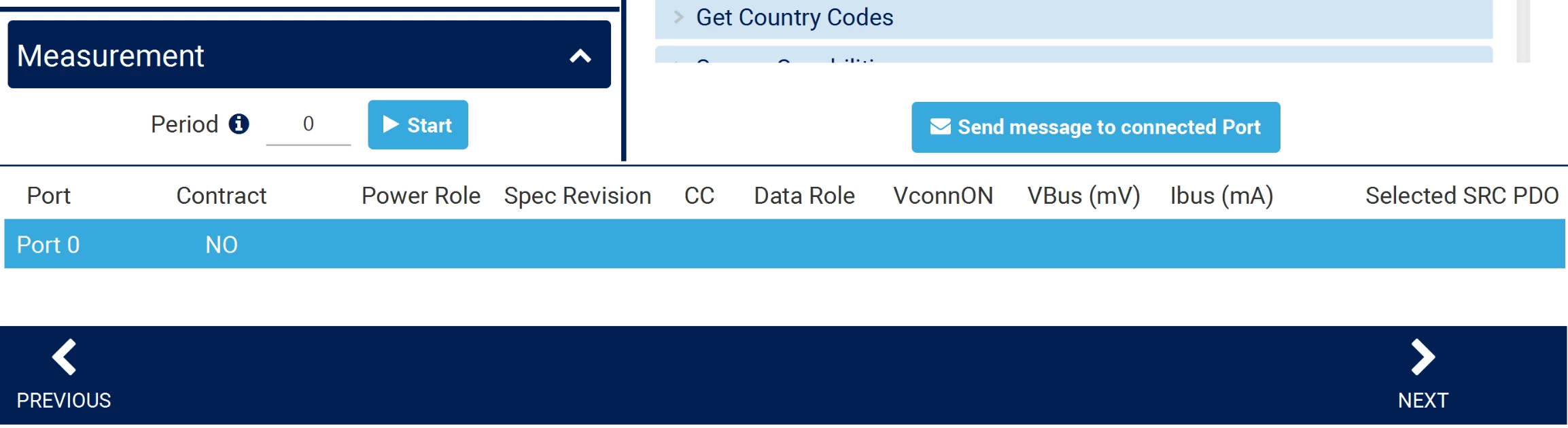

Nicolas P.
Apr 25, 2024 5:00 PM UTC
Hello @acipriano,
You didn't answer to my first question : did you plug two devices together ?
Did you reach explicit contract ? (On, the picture you shared on the ‎2024-04-17 09:59 AM, we see "Contract : NO")

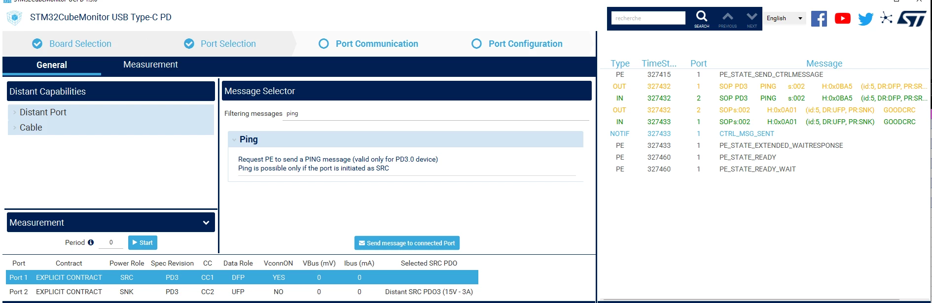

On the bottom lines of UCPD monitor, as on the picture below (here it is a G0-Eval board with port 1 and port 2 looped) we should see this status :
Only if you have two devices connected, you will see protocol exchanges.
As you can see on the trace side, we see messages going out (orange) and going in (green). And every time we get a GoodCRC acknowledge.
For a sink, you need to adapt the PDO request depending on the source capabilities. Have a look at this wiki chapter. You will find links to code examples. Adding PDOs in the UCPD monitor configuration will not trigger automatic voltages request. You need to establish your own strategy in the embedded application.
Getting answers like "not accepted by the stack" means most of the time that you didn't respect the right protocol sequence.
Not having reached explicit contract, or not having the right power role is a good investigation starting point for example.
Regards,
Nicolas

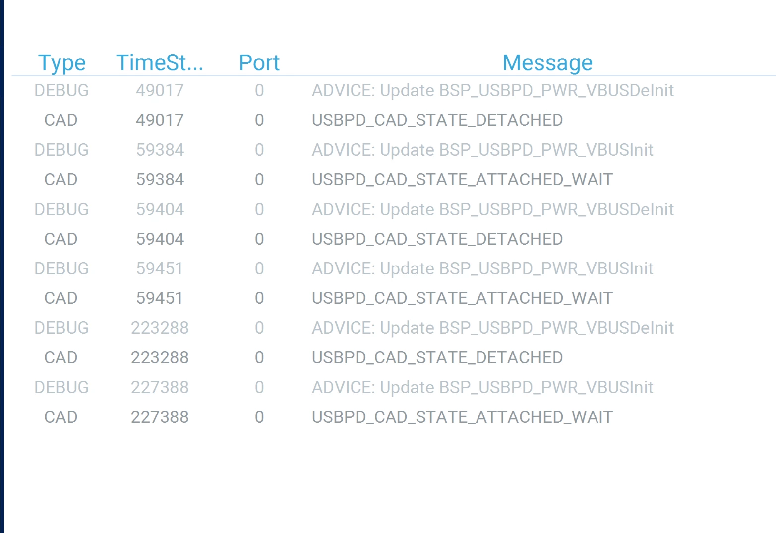

aciprianoAuthor
Apr 26, 2024 7:17 PM UTC
Hey Nicolas,
Thanks for pointing me in the right direction. I'm now getting USBPD CAD messages:
And yes, I'm reading the 5V signal from an oscilloscope and have tried plugging the USBC to my computer and to the wireless charger.
I'm also getting the UCPD interrupts if I attach or detach the USBC cable from my computer.
I managed to adapt the G0 example to get the FreeRTOS to work.
I still can't get the contract to work still. Any further insight into what this might be caused by?
Thanks
Amilcar
Nicolas P.
May 2, 2024 1:59 PM UTC
Hello Amilcar.
Looks better.
However I doubt that the STM32 gets the good VBUS level thanks to the ADC measurement.
Are you starting ADC measurements on VBUS_SENSE pin PC2 ? (See for example BSP_USBPD_PWR_VBUSInit)
Can you try to print the VBUS level thanks to the user button and the code described in the Wiki here ?
What value is returned by BSP_USBPD_PWR_VBUSGetVoltage ?
Because I see some debug messages in your trace that would indicate some code is missing.
Whenever you have "ADVICE: Update xxx" it means that you have to fill in this part of code. (And of course, once filled, you can remove the ADVICE print...)
What is the value of the dead battery pin PB5 (UCPD_DBn) ? (see again the wiki for G0, but you need to adapt it for U5)
Regards,
Nicolas
