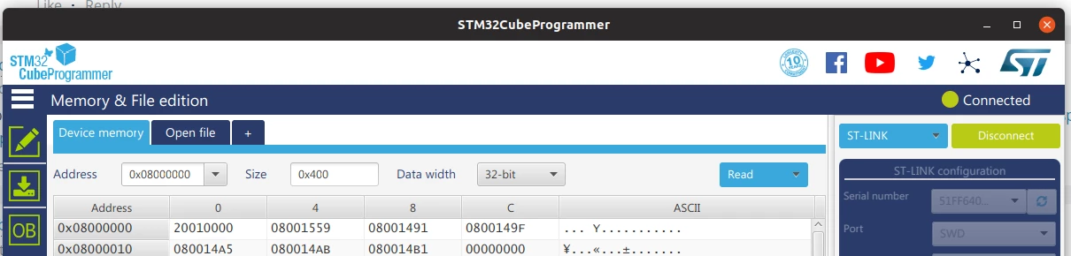

    debugging
    Lead
    Sep 16, 2019 2:39 PM UTC
    My JAVA_HOME default to OpenJDK for coding Android applications to avoid all the legal stuff Oracle is throwing upon the community making everyone (including corporate management) scared of licens fees they "might" have to pay when one does not understand or TL;DR all the "small letters" . Since java fee may apply to embedded systems, it might be good if STM would switch to support OpenJDK (or another way to elminate this anxiety). I installed OpenJFX but that did not help. (Applies to Orcale's java it seems))
    In my case no JAVA_HOME was set in any of my profile, nor the path to it. IThe reason was that something had sets some symbolic links :
    command -v java
    /usr/bin/java
    ls -l /usr/bin/java
    lrwxrwxrwx 1 root root 22 Jan 6 2018 /usr/bin/java -> /etc/alternatives/java
    ls -l /etc/alternatives/java
    lrwxrwxrwx 1 root root 43 Sep 16 21:47 /etc/alternatives/java -> /usr/lib/jvm/java-11-openjdk-amd64/bin/java
    To switch to the JRE following I did
    sudo update-alternatives --config java
     Selection   Path                                           Priority  Status
    * 0           /usr/lib/jvm/java-11-openjdk-amd64/bin/java     1101     auto mode
     1           /usr/lib/jvm/java-11-openjdk-amd64/bin/java     1101     manual mode
     2           /usr/lib/jvm/java-8-openjdk-amd64/jre/bin/java  1081     manual mode
     3           /usr/lib/jvm/java-8-oracle/jre/bin/java         1081     manual mode
    <Select 3>
    source ~/.profile
    * 3           /usr/lib/jvm/java-8-oracle/jre/bin/java         1081     manual mode
    The JAVA_HOME variable was not set accordingly to the jre as well.
    Now run /STM32CubeProgrammer or STMCubeprogrammerIDE
    et voila ! :smiling_face_with_heart_eyes: Love...
     Plug in the STLINK and :face_with_tears_of_joy: .. too much love..
