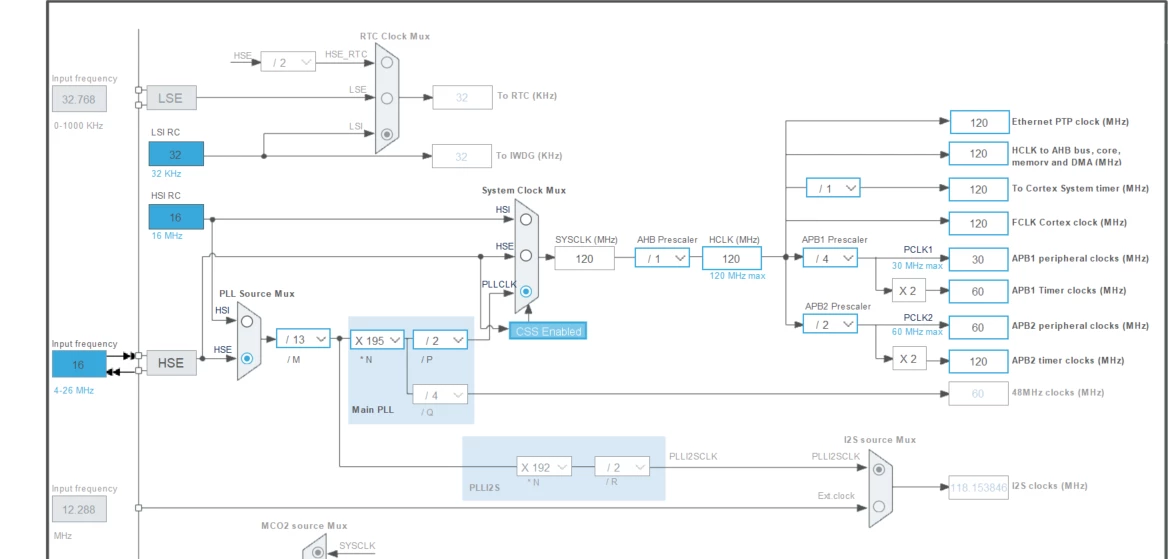

I am using a real XTAL. I updated the clock config according to this
I updated my PLLM to 13 and PLLN to 195 as per the above config, but still I am not getting proper comms out of the UARTS
Lead II
Feb 23, 2024 5:25 AM UTC
OK, this looks good.
But you have to check also which CLK is used for the UART peripheral, and how to you set a baud rate divider for the UART. Your UART can be completely off on clock frequency (and therefore a wrong baud rate).
Add the UART as peripheral to this CubeMX, see the UART core clock and check the UART baud rate divider.
And make sure, the resulting baud rate is pretty correct (not so much off): you cannot set "any" baud rate: just UART clock plus divider: any value in between (or your UART clock is "wrong") results in a wrong baud rate or a baud rate which is a bit off (with an "error" offset, resulting in wrong UART bits).
Measure with a scope the UART bit frequency. Or go through the entire clock tree, including the UART clk selected, the divider set in order to see if it can result in a "reasonable" baud rate.
If you change the PLLs - you have to change potentially also the CLK config for the UART (at least the baud rate divider).

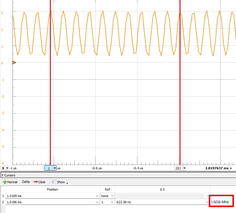

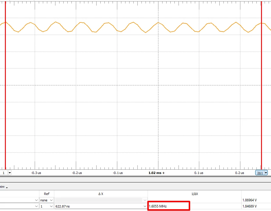

Feb 25, 2024 11:32 PM UTC
I have measured the RCC_OSC_IN which is 16 MHz,
1.6055 MHz x 10  = 16MHz.
Currently in our board PA8 and PC9 are used for i2c comms, So I cant enable MCO1 and MCO2 for measuring the clock output.

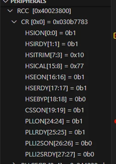

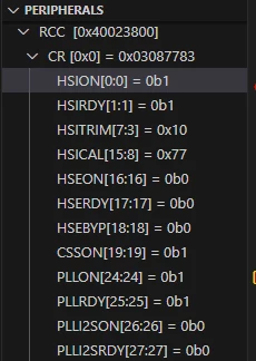

Feb 26, 2024 12:05 AM UTC
This is my USART1 () and RCC regsiters
with HSI
With HSE

waclawek.jan
Feb 26, 2024 10:03 AM UTC
I meant, in RCC all registers which determine APB clock (i.e. besides RCC_CR also RCC_PLLCFGR and RCC_CFGR); and in UART registers which determine its baudrate and general working setup (UART_BRR, UART_CR1, UART_CR2).
My intention was to show you a way how *you* can find out, what's wrong, at the register level (which is how the microcontroller really works), and then work back into Cube/HAL to find out, where is the root of the problem - is it RCC/PLL setup, is it some other RCC setting, is it UART baudrate setup (and within that, is it a problem with the convoluted way how Cube/HAL determines the APB frequency from which UART's clock is derived), is it other UART setting, etc.
In other words, check everything impacting the baudrate, which is probably different from the expectation. You can confirm this by observing UART_Tx pin by oscilloscope/logic analyzer.

Feb 26, 2024 11:13 PM UTC
Thanks JW,
I found its the UART->BRR register that changes when I use the HSE Clock.
On HSI (16MHZ) the UART->BRR is 0x186a. But on HSE(16Mhz) UART->BRR changes to 0x2626.
If I manually update the BRR register (On HSE) with 0x186a then uart works fine at 9600 baudrate.
Can anyone please explain why the BRR register changes If I use HSE with same clock frequency and  clock config as the HSI?
