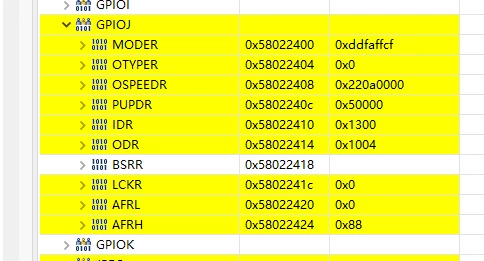

I mean HAL_GPIO_WritePin() or interaction with GPIOJ->ODR and readback via GPIOJ->IDR

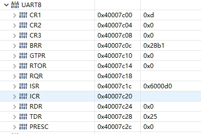

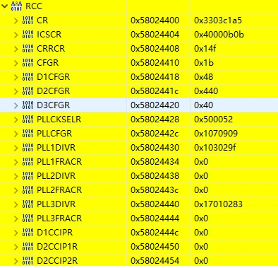

Check the settings in RCC, GPIO and UART8 peripherals, inspect the registers.

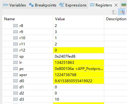

You're checking the right pins? The code is running and not crashing or faulting?

In my debug gpioj run as
In my register D0/D1 as(i dont know its same thing o no)
which part of rcc should i check
uart 8
