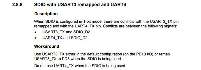

UART4 and SDIO in STM32F103RCT6

Fix the stm cube, as these features do not work at the same time.
I lost a lot of time and money while I figured it out

Probably a good reason not to use 13-year old parts in a new design..
The peripheral/pin muxing method lasted one design iteration.

It could be still worthwhile to display a warning in the CubeMX pin editor, instead of subtly punishing developers who do not turn to the errata reflexively.
While we might sometimes think that an ignorant developer deserves it, punishing does not make much sense from a business standpoint :)

I think, I will use DeInit SDIO to use UART, if i need data from sd card, will be init SDIO again
