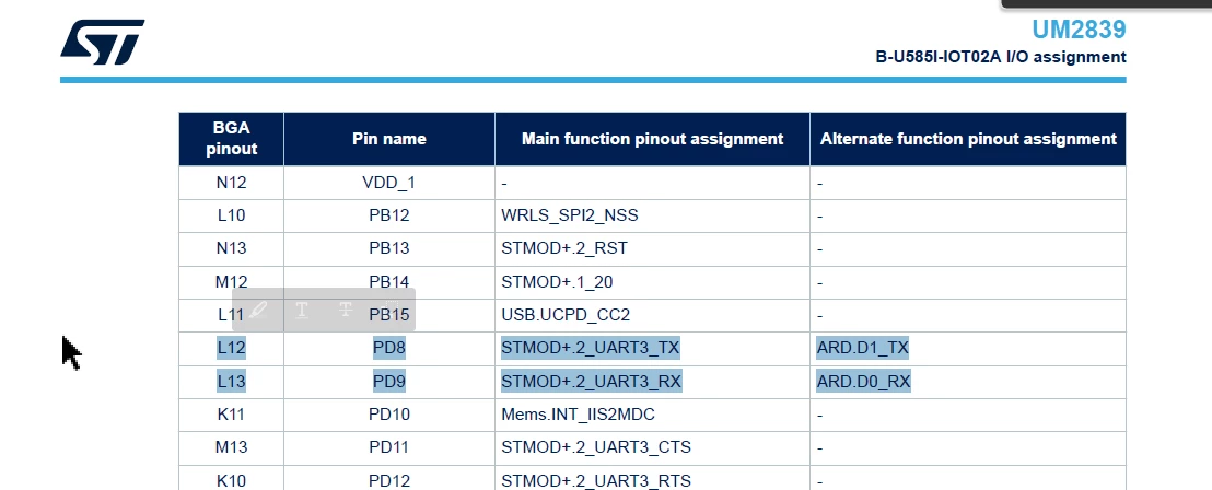

I am creating project by enabling uart3, when write some data on UART3 there is no output on UART_Tx pin.
please let me know any configuration m I missing while creating new project.

Does RX and TX output are assigned to PD8 and PD9? (see picture)
Because by default on CubeMX, UART3 RX/TX pins are assigned to PA5/PA7.
What you can do is used in CubeMx is "ctrl + mouse left button" to change these pins.
Olivier

I have change the status of PH15 pin to high to use UART_3 for PD8 and PD9, it works for me.
