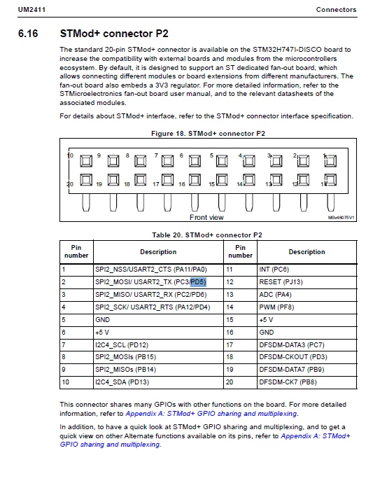

Peter BENSCH
Jul 7, 2025 2:07 PM UTC
Where do you expect something to happen?
You have programmed PD5 and PD6 as RX/TX - have you looked at the schematics to see how they are connected to STMOd+?
Hint: have a look at SB33 and SB35.
Regards

rahulz916Author
Jul 8, 2025 7:57 AM UTC
I am trying to print using this:
HAL_UART_Transmit(&huart2, (uint8_t *)message, strlen(message), HAL_MAX_DELAY);
I have checked the pins that are connected to Stmod+ Fan Out board.
I checked without RTOS and  uart2 is working fine. But I need this uart2 along with touchgfx enabled. I am attaching the pinouts of fanout board
mƎALLEm
Jul 8, 2025 8:05 AM UTC
So if USART2 is working without RTOS and it's not working with TouchGFX. That's not a hardware issue. We need to move the post to the TouchGFX forum board.
