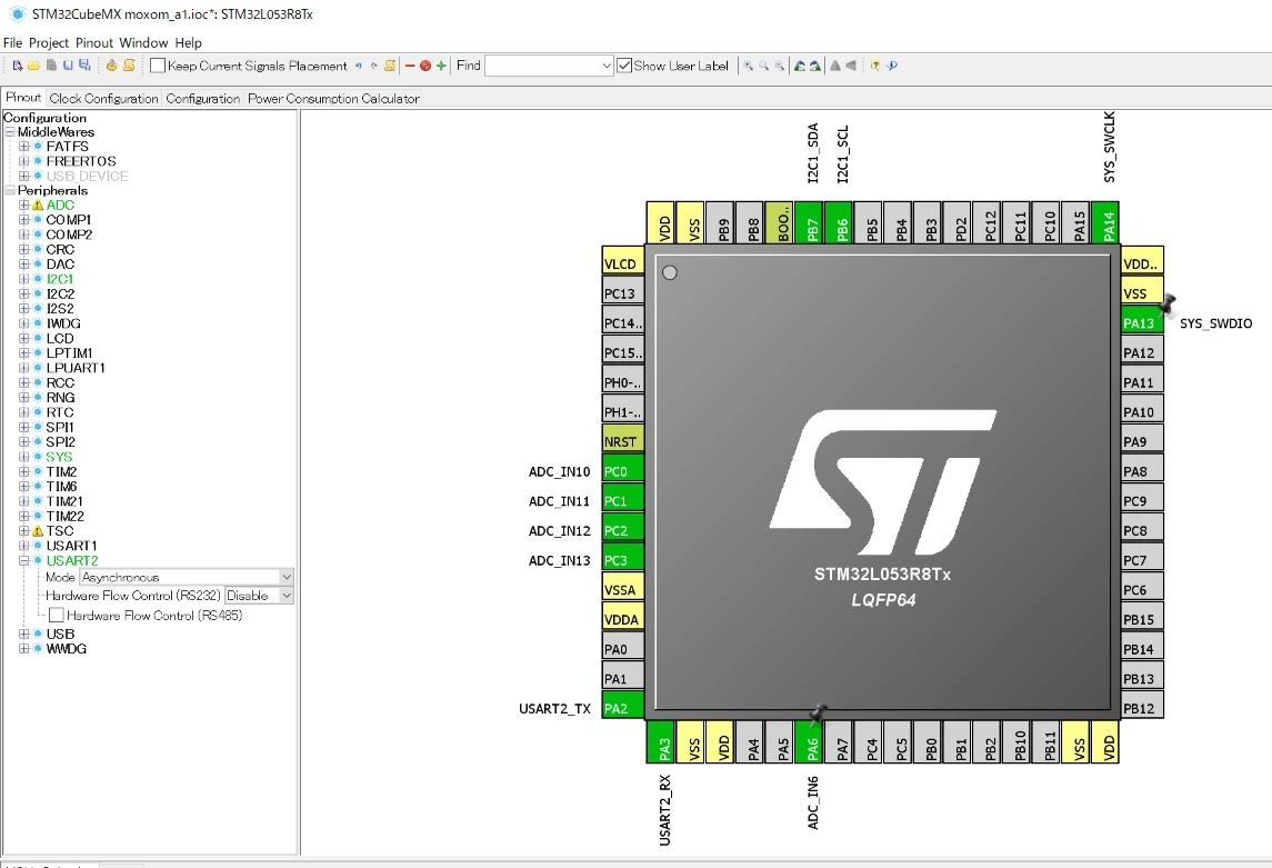

    I use CubeMX and I use PA2 and PA3 for the UART2. When I enable UART2 on the CubeMX, PA2 and PA3 will be the port. No choice. But there is another alies UART2 port on PA13 and PA14. PA13 and PA14 is connected as SWD port on the Nucleo bord.
    I think I don't need set the GPIO setthing when I use UART. I read the reference manual of L0x and it says that, when I use UART TX, I have to set TE=1 and the TX pin will be idle state. This mean I don't have to set PA2 to output or someting. On the debugging, I can see the TE=1 and the PA2(TX) goes hi as idle status of UART.

    I use PA2 and PA3. The color is green that mean OK I think.
