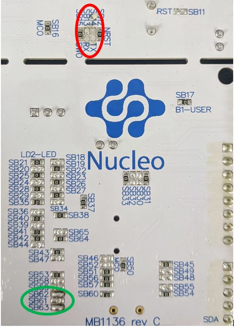

I followed the UART example (https://wiki.st.com/stm32mcu/wiki/STM32StepByStep:Step3_Introduction_to_the_UART) and implemented it on a STM32F051 Discovery kit and on a STM32F446 Nucleo board with pretty much identical settings from CubeMX.
If I scope the STM32F051 I get a TX2 signal out of pin PA2 as expected. If I do the same on the STM32F446 I get nothing. Interestingly I get normal output out of the STM32F446 using Tera Term over USB but if I do the same with STM32F051 I get nothing on terminal.

Check the schematic for solder-bridge options to route to VCP vs Arduino header vs pin headers.

If the signal makes it to the PC, it has to exist on the pins, otherwise how is it getting there? Make sure you're scoping the right pins.

That did it. Thank you clive!

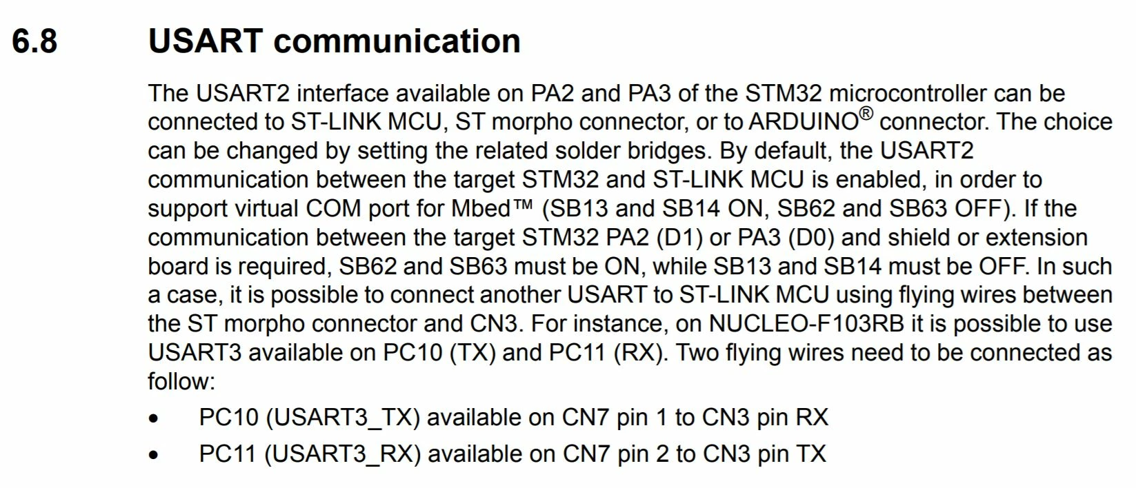

Hopefully this will help someone else. After following clive1's suggestion, I found this in the documentation regarding USART and solder bridges. That's what I did in the picture at bottom and everything works as I wished before. This was not in my radar, so better double check documentation next time. Thank you!
De-soldered 0 ohm resistor between SB13 and SB14 (red circle). Soldered bridges SB62 and SB63 (green).0693W000005AzvDQAS.jpg
