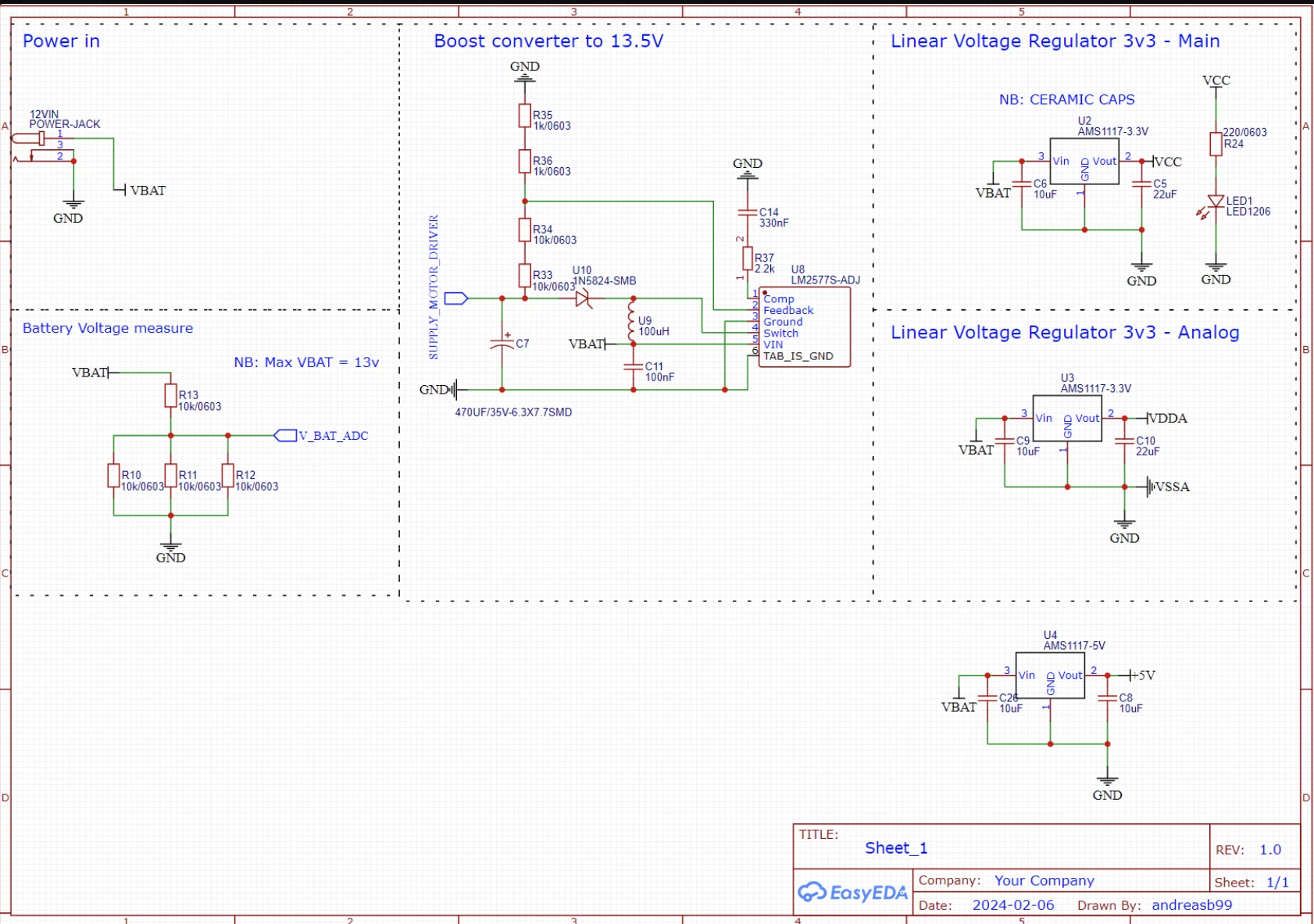

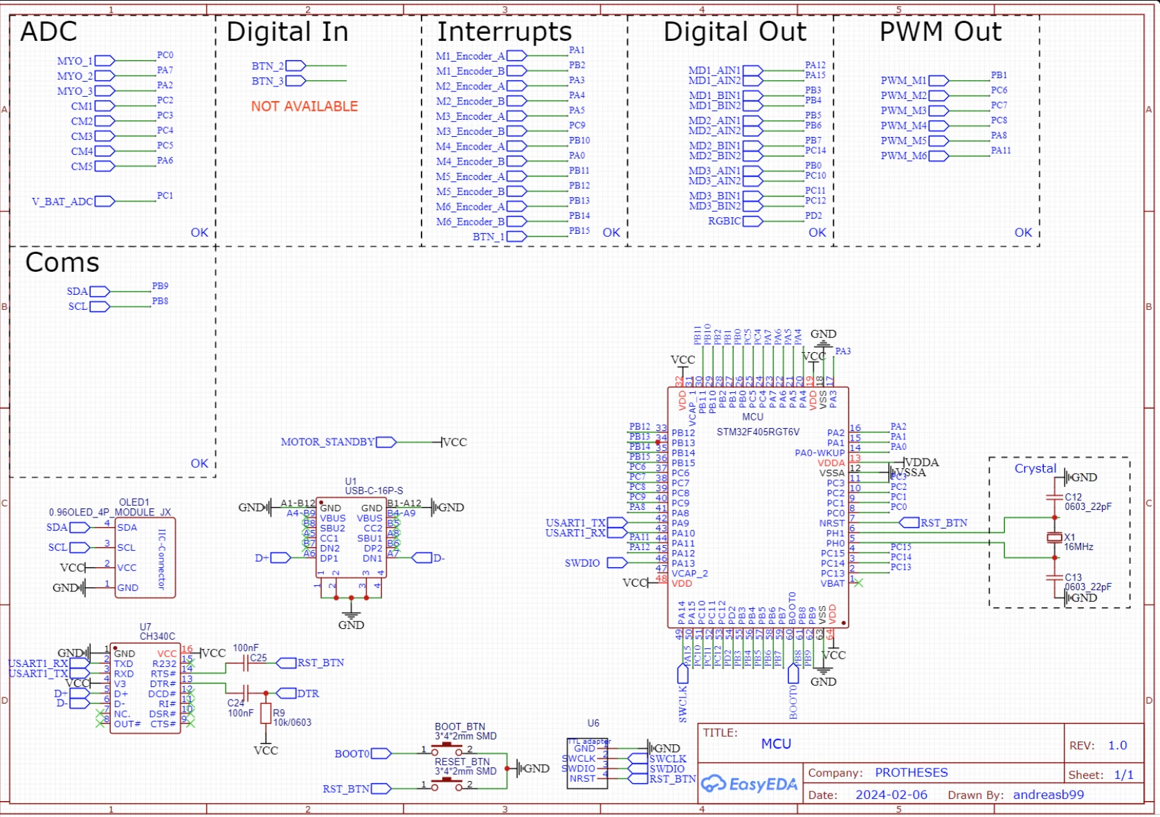

I have a custom PCB which has an CH340C (U7) serial chip and a USB-C (U1) port. See wiring diagram:

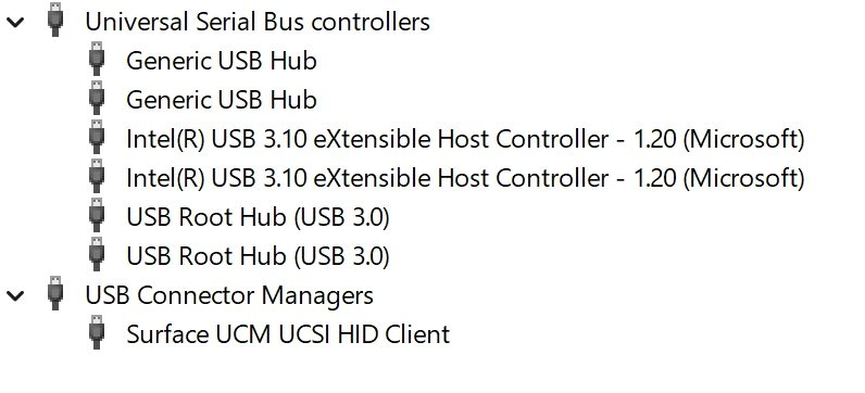

I have set up my project in STM32CubeIDE and have connected to my MCU with a ST-LINK/V2 as of now.
The problem is I cant find the Serial Port for my USB-C in the Device Manager.

No: things on the PC just see a COM port - they neither know nor care what hardware lies behind it.
If the COM port is not appearing in Device Manager, then nothing on the PC can see it at all.
This is nothing to do with ST - it's all down to the CH340C.

Where does your VCC power supply come from?

I see, then the fault must be in the driver or someting hardware. I have however measured the connections between the STM32 (RX/TX) and the serial chip (CH340C).
The VCC power suply comes from a linear voltage Regulator 3v3 (U2). See wiring diagram.
Any tips for the CH340C?
Yes.
Your problem is in CH430C, or between it and the PC - not between the CH430C and STM32.
Nothing specific.
Are you sure it's genuine & working?
Check carefully that it's correctly oriented, all joints are good, no shorts, etc.
Do you have a known-working CH430C to compare against?
The STM32F405RGT6 has USB - why not use that?
