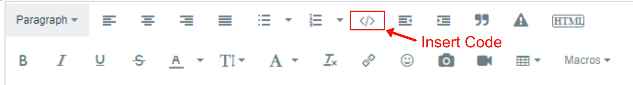

Use the </> when posting code so it's formatted and readable. Upload your IOC file
If a reply has proven helpful, click on Accept as Solution so that it'll show at top of the post.CAN Jammer an open source CAN bus hacking toolCANableV3 Open Source

re-edit your first post, use the </> icon, paste your code so it's properly formatted and readable.
