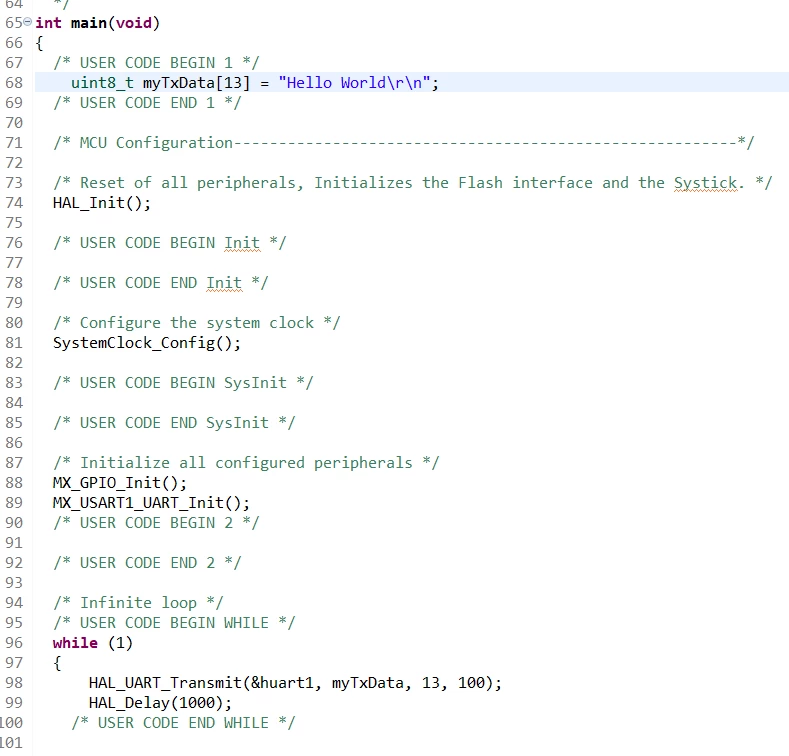

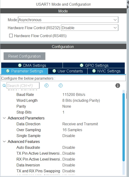

I would like to transmit data via USART and read the data sent to computer via a terminal(I have tried Putty and Real Term so far). To that end, I activate 0693W00000NqsasQAB.pngMy USART configuration is seen as above. I also wrote the code below:
uint8_t myTxData[13] = "Hello World\r\n";
while (1)
 /* USER CODE END WHILE */
 /* USER CODE BEGIN 3 */
 	 HAL_StatusTypeDef res = HAL_UART_Transmit(&huart1, myTxData, 13, 10);
	 if(!res) {
		 HAL_GPIO_TogglePin(GPIOI, GPIO_PIN_1);
		 HAL_Delay(1000);
Note that I only put here inside the while loop. The other statements were generated by CubeMX.
Normally my code sends data to my pc if res is true, in other words, if it is HAL_OK, and also toggles the LED. Since it couldn't see the data in the terminal, I changed the condition in if statement, and saw that the led is toggled in each second. Therefore, I concluded that my USART channel does not work. What's the issue?
Thx for your help in advance.

This doesn't show any of the initialization code for the USART, clocks and pins.
Check it is using the right pins.
Check pins with a scope.
Check bit timings of 'U' pattern, confirm baud rate settings.
The USART TX pin uses CMOS levels, this is not compatible with RS232 levels.

No details on which STM32 you are using, the board or the pins involved.
Code provided so far is superficial. Issue likely not timeout related, should still see 10 or so characters.
Perhaps look at other Cube/HAL examples, where information is less hidden.

What is see is your timeout period is 10, change that to 100.
Next is check the baudrate on your serial terminal, it should be 115200.
It must work now!!

Did you change the timeout?
what is the board that you are using?

I am using STM32F746NG Discovery board. I changed timeout to 100 as you said, and tried more different values, i.e., HAL_MAX_DELAY. But still does not work.
My RCC setting is that I enabled HSE and configured max frequency value, which 216 kHz.

Your program runs on STM32F746, not on ST-Link CPU (STM32F103, which uses its PA2 and PA3 to connect to F746). The schematics of Discovery board shows the pins used in F746 for UART VCP connection are PA9 and PB7, which are USART1 TX and RX pins.

Thank you sooo much. This solves my problem. I have a question, how did you determine that the correct ones are PA9 and PB7? I looked at the datasheet more times but I couldn't determine it.

Datasheet, reference manual etc. are for a microcontroller. Board features are documented in board's user manual and schematic.
