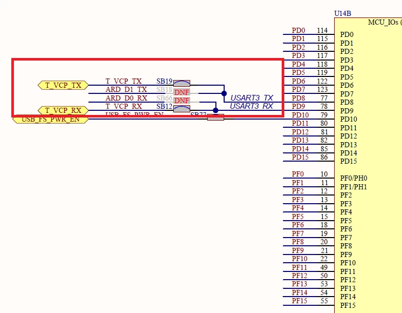

UART Transmission on STM32 Nucleo-h723zg
I am using STM32 Nucleo-h723zg for a UART serial transmission using UART4 and UART7. I have used UART4 only in my code to test since using both was not working. Still, nothing is showing on my RealTerm serial monitor. I used STM32 Cube IDE. I don't know why I can't see data being transmitted on the serial monitor.

    mƎALLEm
    mƎALLEmBest answer
    According to the board's schematics you need to use USART3 (Tx: PD8 and Rx: PD9) and use the virtual comport over STL-Link.
    Unless you have a specific HW connected between UART4 or UART7 and your PC.
    5 replies
    mƎALLEm
    mƎALLEmBest answer
    SAWAuthor
    I have changed my code a bit and used USART3 but still no result on the serial monitor

    What GPIOs you selected for UART3? SB12 and SB19 are soldered?
    Did you select the same UART parameters for USART3 as you did for the terminal?
    See also this thread: https://community.st.com/t5/stm32-mcus-products/stm32-nucleo-h7a3zi-board-uart-issue/m-p/712867
    SAWAuthor
    I managed to do the UART transceiving. Only the USART3 was working. I had to change the data type from a string to a buffer for the STM32h723zg. The string format was working when I used stm32 nucleo C031C6. What is the reason behind this?
