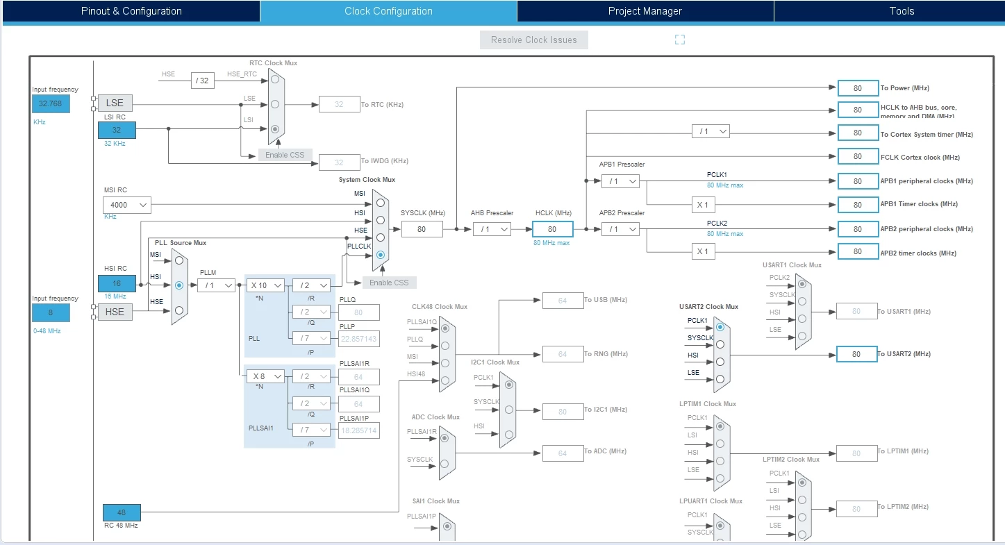

  1. MCU : STM32L432 Nucleo-32 board
  2. FTDI Board : MIKROE USB UART Click Board

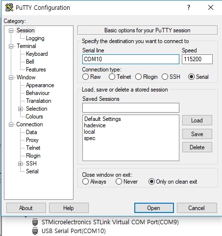

  3. Computer Interface : watching a data using PuTTY on Window 10
  4. IDE : STM32CubeIDE workspace 1.4.0

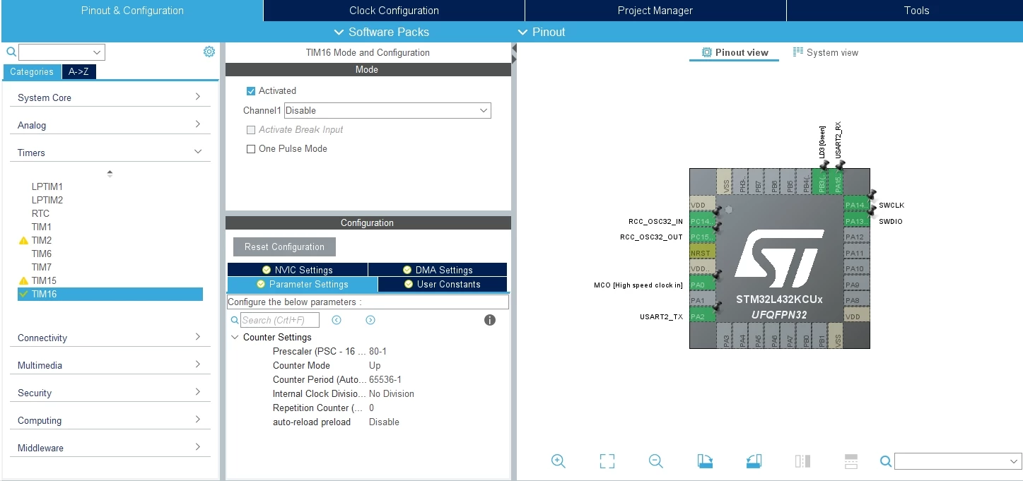

  5. MCU Pin/Clock Setting : Attached file(clock configuration), Attached file(pin setting)
  6. PuTTY Setting : Attached file(PuTTY Setting)
​[Problem]

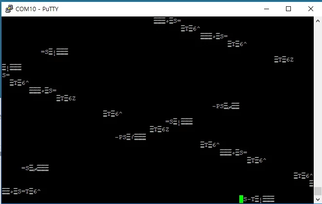

  1. Problem : As you can see in the Attached file(prob), My computer cannot recieve data from Nucleo board.
  2. Self diagnosis : (1) Using Osilloscope, I checked the UART TX Signals to FTDI(Click) Board. (2) Also, I set USART as Asynchronous Mode on the Cube MX.

Definitely looks like a clock issue. What bit rate did the oscilloscope show?
Check to see if RCC_HSICALIBRATION_DEFAULT gets set correctly.

Really Thank you so much. It's solved at once. :D
I divided  RCC_HSICALIBRATION_DEFAULT as '2'
