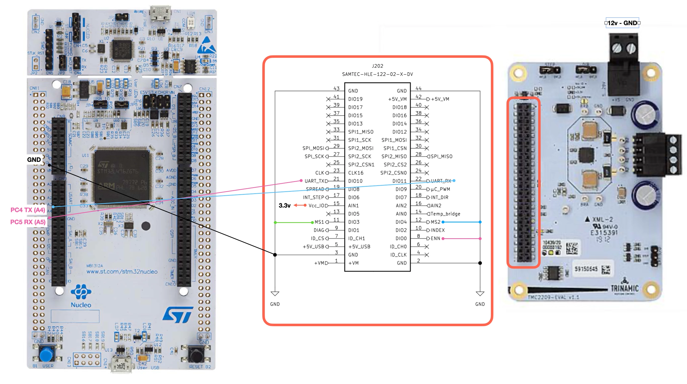

Hi
I have to connect an STM34 Nucleo board to a TMC2209. I have to setup a single wire UART. Only TX is connected with the TMC board.
I transmitted a datagram and when I try to receive the response I get back the initial data I have e sent.
Does anybody know what could be happening?

    >>Please, I need help. I am in a bit of a hurry
    It's the internet, nobody cares.
    Lead with details, code and wiring. Links to datasheets.
    Assuming STM32G4xx something from prior posts.
    Any code examples for any other MCU you've found in two weeks?
    The TMC2209 is wired to the STM32G4 how, using what pins, which UART?
    Single wire apt to see what you send, need to config the pins suitably, and wait for response.
    Can use a two pin mode with a resistor. That way the idle TX just pulls the RX high, but doesn't block response.
    Should wait for UART TC, and then await response.
    IC probably going to ignore messages with bad CRC.
    https://www.trinamic.com/fileadmin/assets/Products/ICs_Documents/TMC2209_datasheet_rev1.08.pdf

    Hi Tesla
    You are right, we have STM32G4xx on our project but I am using a NUCLEO-L496ZG to try to make the first integration.
        UM2179 STM32 Nucleo-144 boards (MB1312)
    I have to connect with UART with the TMC2209-EVAL driver board.
     TMC2209 Datasheet
    This is a simplified diagram since the evaluation board is already adding that resistor.
    This is how I have connected the boards:
    Regarding the CRC I have used the CRC functions they use in the full evaluation kit that you can find here: https://github.com/trinamic/TMC-EvalSystem/releases/tag/3.08.24, the CRC they use in the TMC2209 datasheet of the driver (see above link) and event the CRC from the nucleo board but still nothing.
    There source code is attached to the post.
    I have been through lots of code. I haven't seen any for this eval board and STM32. I have seen a lot of code for Arduino. The code from the evaluation kit helped me to understand how the datagrams should be sent together with the TMC driver datasheet. But I have found some discrepancies between the documentation and the Arduino and the evaluation board code... I have tried all sort of configurations for days.
    The current source code I have uploaded is not receiving anything anymore.
    Thanks in advance for taking your time. And please, let me know that else I could provide in case you need it.
    Best regards.

    The UART_TX pin on the header needs to go to the STM32 USARTx_TX pin, RX to RX
    Currently I think you're driving a High push-pull signal directly into their output.
    MS1/MS2 not connected, have internal pull-down, will be SLAVEADDR = 0

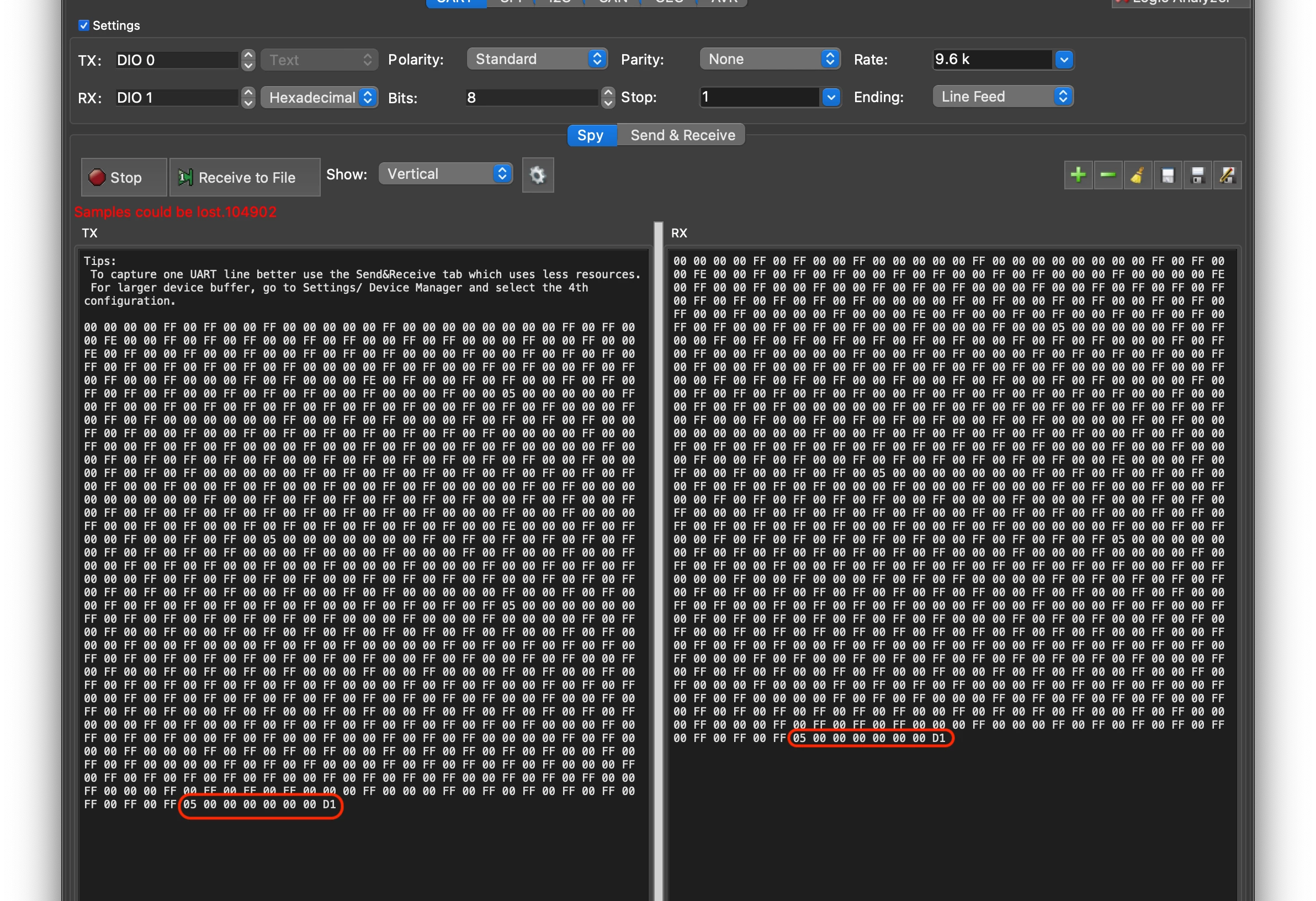

    I have used protocol tool with my AD2 and the data seems to be transmitted but nothing is back from TMC.

    Sorry, it took me a while to reply but I have been very busy implementing this. One day before you wrote me I received a TMC2209-BOB and it worked perfectly as intended.
    You are right. The TMC2209-eval board is not working even well with the whole evaluation kit… it is incredible that one gets charged for such expensive board when the documentation is not aligned and the hardware is not working at all as intended… I ordered also a TMC5160 evaluation kit which uses SPI and that was working fine from scratch. But the TMC2209-eval kit is totally messed up.
    I recommend using the BOB to those who wants to start with TMC2209.
    @Community member​ Thank you very much. Your code and tips help me out also to code the UART with the BOB much easily. Without your help would have been much difficult to understand what was happening.
