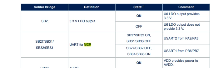

I am still a beginner in STMicroelectronics programming. I am trying to do UART serial communication on STM32 Nucleo C031C6. USART2 seemed to be disabled on CubeMx while trying to configure the pins so I used USART1. I am using RealTerm as my serial monitor. I cannot see my message being transmitted.
I have used pin PB6 and PB7 as per the datasheet.

Hello @SAW
To be able to see the Message on your serial monitor, you have to use the USART2 or use USART1 after soldering SB31 and SB33 and taking off the SB27 and SB32:
since by default, the USART interface connected to The VCP interface is USART2.

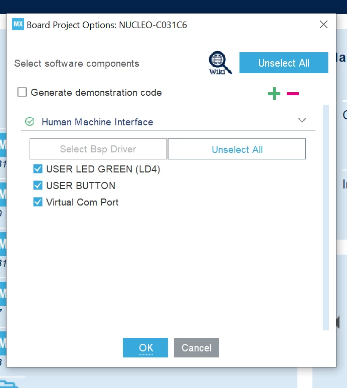

If you want to be able to set the USART2 you have to select the Board and will receiving this Tab:
Select "Unselect All" then OK.
Best Regards.
