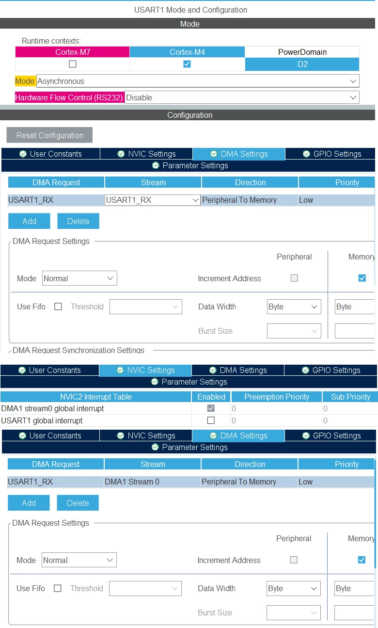

I am using NUCLEO-H745ZIQ for the UART communication.
I try to use the UART RX Interrupt to get the data from PC. I set the UART parameters as same as I was use for the STM32F4 which work fine. Currently, I would like to use both of CM4 and CM7, CM4 used UART1 and CM7 used UART3.
My problem is the UART Rx interrupt is go to HAL_UART_RxCpltCallback only in the CM7, but for the CM4, it never go to the HAL_UART_RxCpltCallback function.
However, for the other interrupts are work find for both CM4 and CM7 such as timer interrupts.
Could you please help me, may be I did some miss configuration.

Hello @PNaro.1​ ,
Would you share your UART1 configuration please?
This issue may occur if the Interrupt is disabled. Could you ensure that the UART1 interrupt is enabled on the CM4 core. Also, you may need to check the UART1 interrupt priority. You may need to check the NVIC configuration.

Hi @F.Belaid​
Thanks for replying me.
This is my UART1 configuration.
I tried both enable and disable the UART1 global interrupt but it is not work.
I already checked the NVIC2 which control the interrupt for CM4 to make sure that the UART1 global interrupt and DMA interrupt are enabled.
What about the interrupt priority? Which priority should I set?

You should enable USART1 global interrupt.
It is important to consider the priorities of the interrupts. Depending on your application, while the processor running in the handler mode multiple interrupts, you can set the priority of each peripheral to preempt or be preempted.
