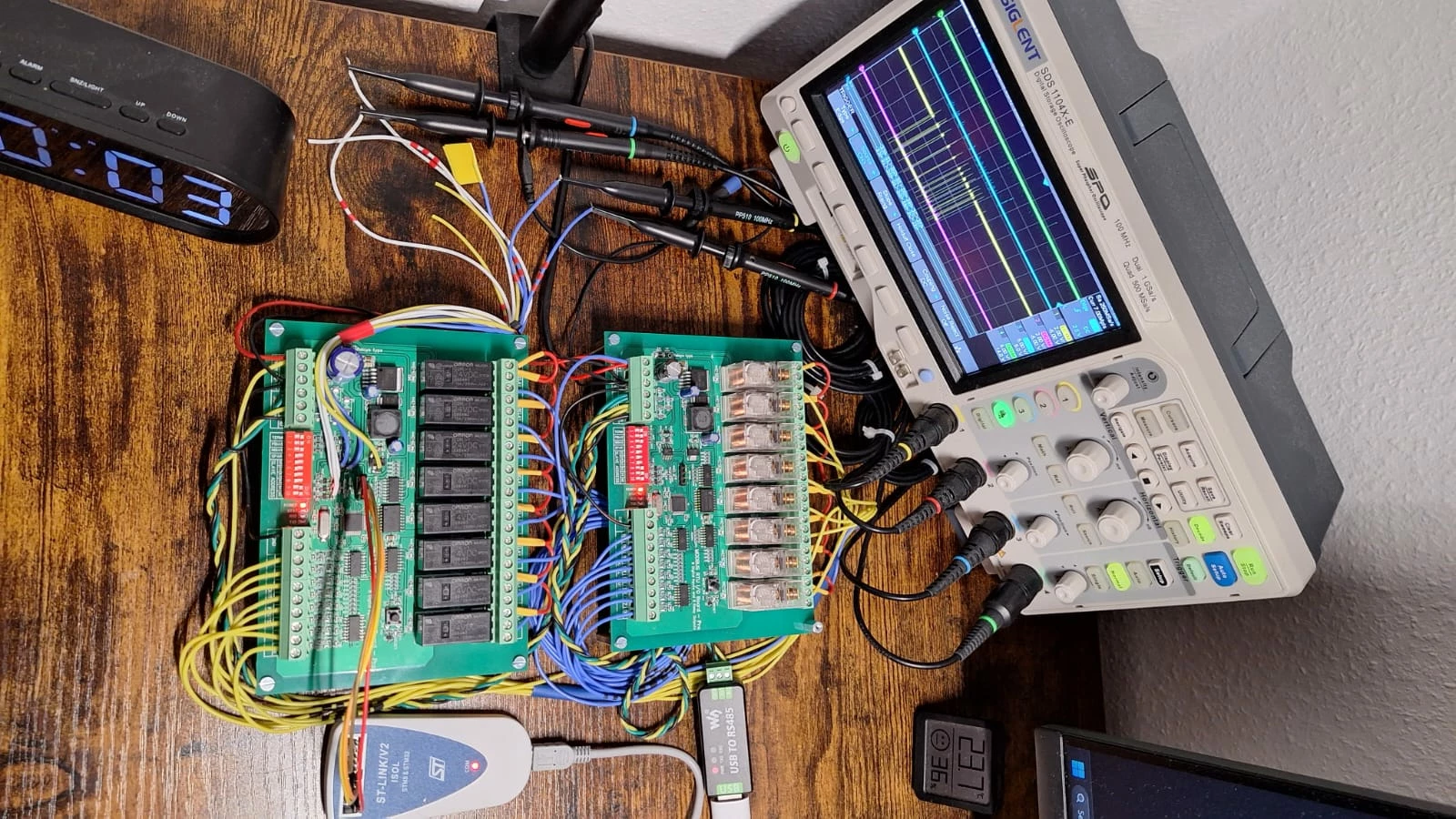

I am using STM32F030C8T6 to implement Modbus RTU protocol which uses UART and RS485 as physical layer.
I have already implemented the complete protocol with UART's RXNE and TCIE interrupts.
Now I am trying to implement through DMA by which I will free micro-controller core from lot of interrupts.
With great support from ST forum, I already implemented Tx using DMA.
Now I m trying to implement the RX logics using UART through DMA.
As usual I am stuck somewhere and I request your support. Please help me to fix this issue too.

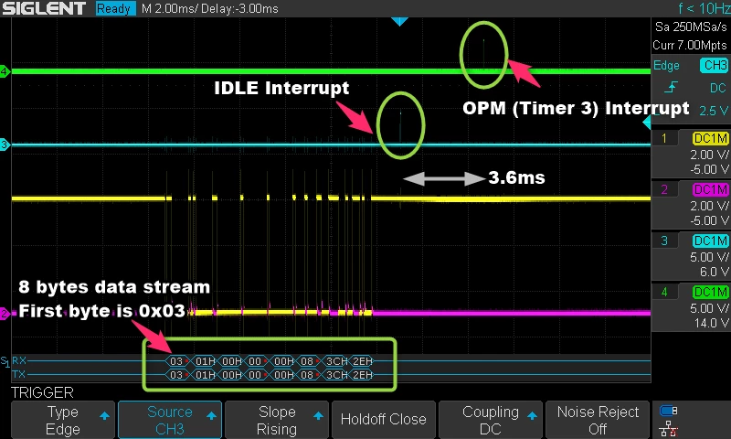

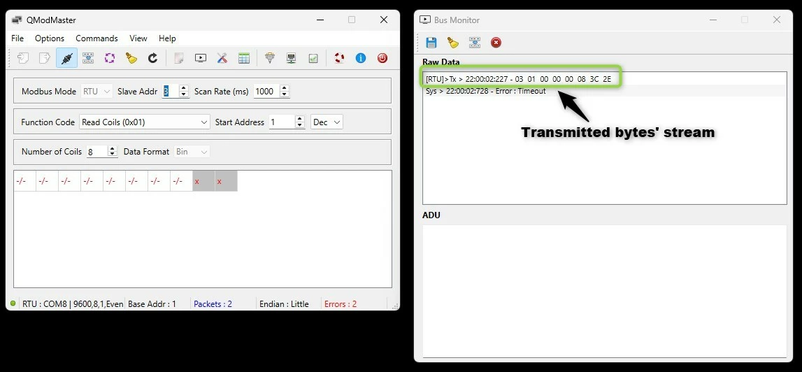

As per the Modbus protocol, my hardware as a slave will read sequence bytes, process and then respond.
Length of sequence will not be known during reception of the bytes.
Slave must decide the length of frame when there a silence in the Rx for more than 3.5 times of character length.
For this logic, I have used IDLE Line interrupt to detect initial silence then, inside the IDLE ISR I start Timer 3 in OPM for 3.6ms (time depends Baud rate and number of 11 bits streams).
So if there is silence for more than 3.6ms, slave will decide that end of Rx is received, and further processing will be started.
Here I have provided you the complete code related to RX to analyze further.

void USART1_IRQHandler(void)
 uint32_t isr = USART1->ISR;
 volatile uint32_t dummy;
 // --- IDLE line detected (end of Modbus RTU frame) ---
 if (isr & USART_ISR_IDLE)
 	Switch_Status_LED_ON;
 	USART1->ICR = USART_ICR_IDLECF;
 	dummy = USART1->ISR; // Clear IDLE flag by reading ISR
 dummy = USART1->RDR; // Clear with RDR read
 (void)dummy;
 // Restart TIM3 safely (corrected)
 TIM3->CR1 &= ~TIM_CR1_CEN; // Stop timer
 TIM3->DIER &= ~TIM_DIER_UIE; // Disable interrupt during config
 TIM3->SR = 0; // Clear all interrupt flags (especially UIF)
 TIM3->PSC = 39; // Prescaler
 TIM3->ARR = 3640; // Auto-reload value for 3.64 ms
 TIM3->CNT = 0; // Reset counter

I use a Modbus Master simulation software named "QModMaster" a generate a stream of UART data.
For testing, I generate a data stream of 0x03 0x01 0x00 0x00 0x00 0x08 0x3C 0x2E.
We can confirm the data stream in oscilloscope plot too.
Inside the function void "USART1_IRQHandler()", in every IDLE interrupt, I restart the Timer 3 in OPM with 3.6mS.
To check its functionality by oscilloscope, I placed code to pulse a port pin (Switch_Status_LED_ON and Switch_Status_LED_OFF).
The oscilloscope plot confirm that, this function is properly executed when IDLE is detected.
Then after 3.6mS, Timer 3 ISR is also executed.
I confirmed this by pulsing another port pin (Switch_RXD_LED_ON and Switch_RXD_LED_OFF).
The oscilloscope plot confirm that, this time out function is also properly executed at 3.64mS from detection of IDLE.
Further to test the functionality of DMA reception, I checked RX_Array_Size, first element of Received array by simple if else function.
But data received by DMA is not as per the expectation.
I was told that, because of lesser control of micro controller over Rx and noise in Rx lines, this task may not be straight forward.
But with the implementation of Time out function to Reset DMA transfer and count, reception must be reliable. The very first data received during power up may be unknown.
From the next cycles, things must work fine.
Please let me know, what is going on wrong.
