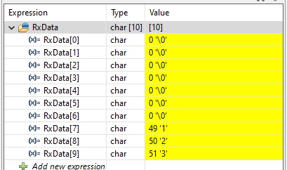

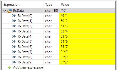

I am very new to STM and got some problems on serial UART. I can get data from my serial, but my problem is if the data received is less than the length of the array, the next data received doesn't overwrite the first data. How do I fix this problem?
The first data is this.
The second data after clearing the array is like this.
The data sent for the board to receive is just "1234567". What I want to achieve is if the data received is less than the array length, the second data I get after that don't continue like the picture above.
The code used is shown below.

On most STM32 platforms the UART interrupts for every byte, you can use the call-back to deal with a full message length, or you can monitor/harvest the buffer after the call-in, or flag there's more data for processing.
Or you can code something more effective yourself.
A large circular DMA buffer can also be used in-lieu of a HW FIFO, and swept periodically. The UART->RDR is 16-bit wide, which can be exploited to indicate what in the buffer is dirty vs clean.

You can use HAL_UARTEx_ReceiveToIdle_DMA instead and restart it after every reception.

You're using HAL_UART_Receive_IT incorrectly. It should be called once before the while loop to initially enable the interrupt. After you receive data, HAL_UART_RxCpltCallback is called. You can then call HAL_UART_Receive_IT again.
If you have variable data length, then use HAL_UARTEx_ReceiveToIdle_DMA or HAL_UARTEx_ReceiveToIdle_IT
See this project https://github.com/karlyamashita/Nucleo-G431RB_Three_UART/wiki
