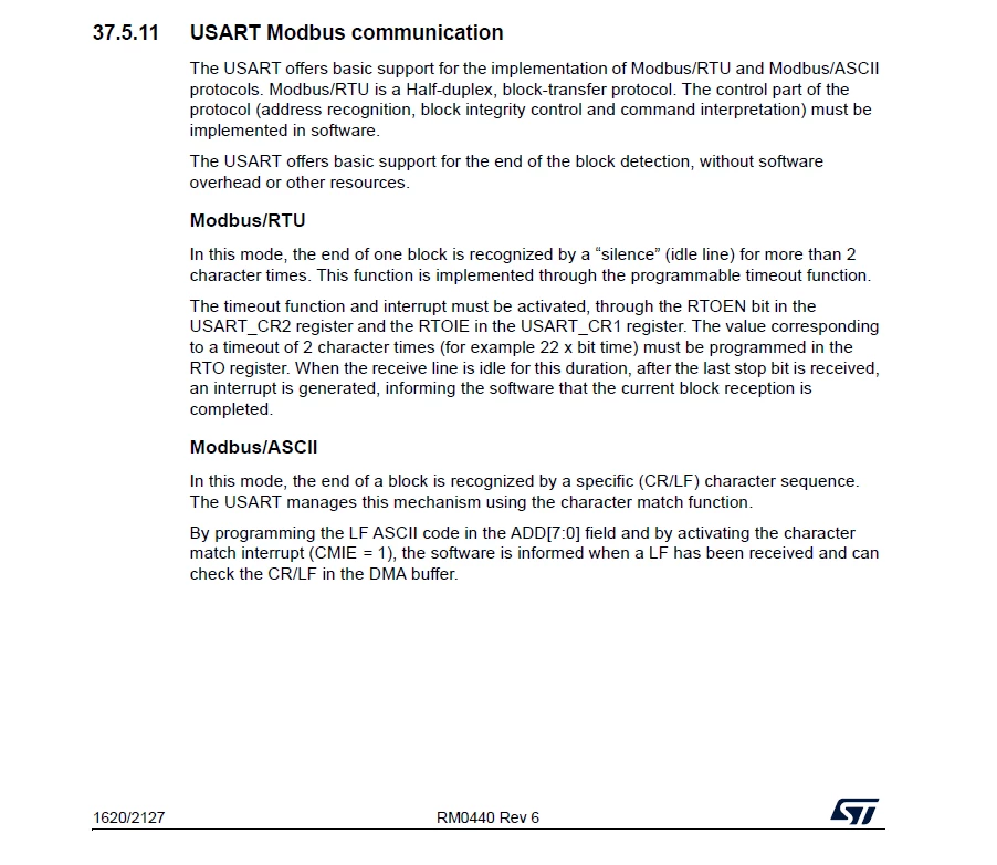

Your microcontroller support Modbus RTU/ASCII regarding recognize silence. Please see reference manual RM0440.

Consider implementing your own USART interrupt handler, that way you can measure the inter-character gap time (using a timer that you reset when a character is received); a gap time > 3.5 char can be used to indicate that the received message is complete.
