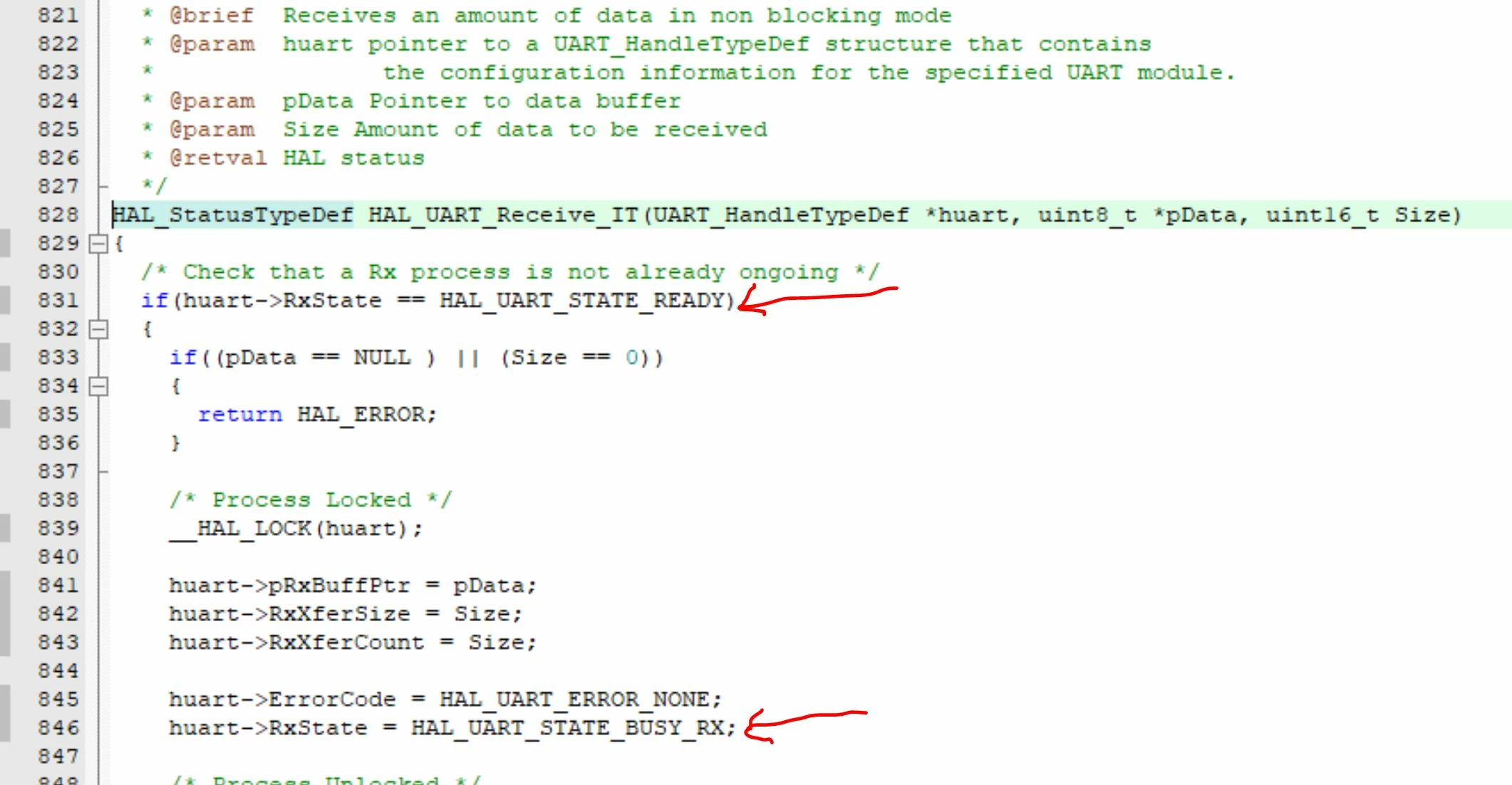

1. HAL_UART_Receive_IT:
It checks if huart->RxState is HAL_UART_STATE_READY.
If true, it sets huart->RxState to HAL_UART_STATE_BUSY_RX.

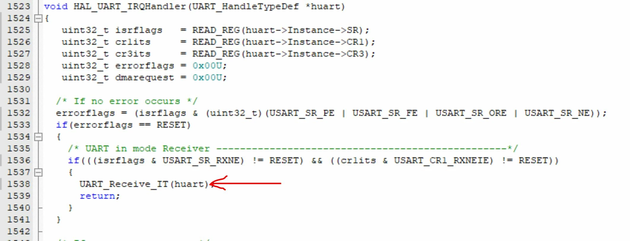

2. When Data is received into DataRegister HAL_UART_IRQHandler calls UART_Receive_IT.

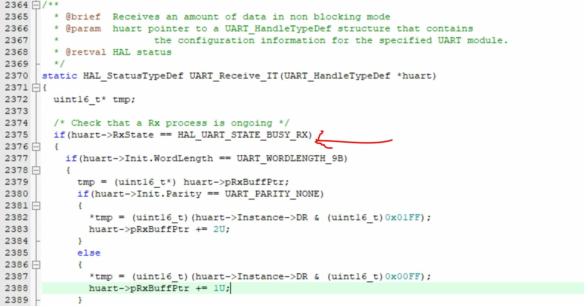

3. UART_Receive_IT:
checks if huart->RxState is HAL_UART_STATE_BUSY_RX.
If true, and when all data bytes are received, it sets huart->RxState to HAL_UART_STATE_READY.
Issue Scenario: Suppose due to some noise on UART line USART_SR_RXNE bit is set and HAL_UART_IRQHandler is triggered, and it calls UART_Receive_IT. Now UART_Receive_IT checks if huart->RxState is HAL_UART_STATE_BUSY_RX , its Not since HAL_UART_Receive_IT was not called by user. In this case the UART_Receive_IT exits without doing anything and HAL_UART_IRQHandler keeps getting triggered repeatedly since USART_SR_RXNE is not cleared and execution is stuck.

I did some further debugging and found out what is happening. This issue happens whenever there is a noise on uart line. Sequence is as follows:
1. DeInit and Init UART which sets huart->RxState is HAL_UART_STATE_READY.
2. Transmit data using interrupt by calling HAL_UART_Transmit_IT, I see HAL_UART_TxCpltCallback is called and transmission is successful.
3. Next I call HAL_UART_Receive_IT which sets USART_SR_RXNE and wait for HAL_UART_RxCpltCallback, may be due to noise the HAL_UART_RxCpltCallback is not called and reception is unsuccessful, my timeout timer callback is called and I exit. But at this point USART_SR_RXNE is still set since HAL_UART_RxCpltCallback is never called.
4. for next data, I call DeInit and Init UART which sets huart->RxState is HAL_UART_STATE_READY. (Note that init doesn't clear USART_SR_RXNE)
5. Transmit data using interrupt by calling HAL_UART_Transmit_IT, At this point UART HAL_UART_IRQHandler is called. Inside the HAL_UART_IRQHandler first they check for Receive - UART_Receive_IT. In UART_Receive_IT it checks if(huart->RxState == HAL_UART_STATE_BUSY_RX) , since during init huart->RxState is HAL_UART_STATE_READY. the check is not satisfied and it exits UART IRQ handler without doing anything. But still since USART_SR_RXNE bit is not cleared the interrupt keeps repeatedly calling  HAL_UART_IRQHandler without giving time for any other tasks and system hangs.
