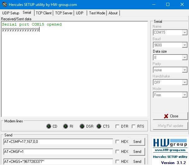

Hi,  am using STM32F103C8T6, I wrote code with keil for uart1 for the tx pin PA9 and rx
pin PA10, am just sending a character repeatedly, but I didn't receive the character what I am sending, I am using CP2102 device between my controller and my PC. I will show my code, and my output , so kindly suggest me the solution.

OUTPUT:

    AvaTar
    Senior III
    May 28, 2018
    Posted on May 28, 2018 at 14:40
    // Configure the SysTick timer to overflow every 1 us
    SysTick_Config(SystemCoreClock / 1000000);
    Honestly ?
    Think about the implications.
    Especially in the light of this:
    USART1->BRR = 8000000L/9600L;
    Are you sure ?
    Tesla DeLorean
    Guru
    May 28, 2018
    Posted on May 28, 2018 at 14:52
    Is APB2 running at 8 MHz? Check what is happening in SystemInit()
    Output a 'U' character continuously, and scope the USART1_TX pin and confirm the bit timing.
    Use a debugger and inspect the RCC, GPIO and USART register settings
