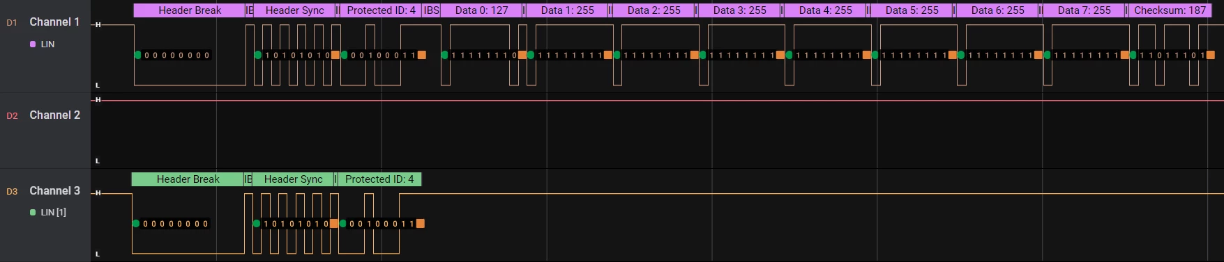

For me, something similar to what my colleague says is happening, but a little bit different
I'm describing the project I'm doing to see if I can solve it.
I am using the USART1 configured as LIN mode with the following parameters:
/* USER CODE BEGIN USART1_Init 1 */
/* USER CODE END USART1_Init 1 */
huart1.Instance = USART1;
huart1.Init.BaudRate = 19200;
huart1.Init.WordLength = UART_WORDLENGTH_8B;
huart1.Init.StopBits = UART_STOPBITS_1;
huart1.Init.Parity = UART_PARITY_NONE;
huart1.Init.Mode = UART_MODE_TX_RX;
huart1.Init.HwFlowCtl = UART_HWCONTROL_NONE;
huart1.Init.OverSampling = UART_OVERSAMPLING_16;
if (HAL_LIN_Init(&huart1, UART_LINBREAKDETECTLENGTH_10B) != HAL_OK)
Error_Handler();
In the picture "linrequest and linresponse" you can see on channel 3 sending the LIN break+ sync+protectedID signal and on the channel 1 signal you can see the response of the LIN slave DATA(8 bytes)+ CHK.
The code I have implemented asks the slave if it is on the bus and if it is on the bus it sends me back information.

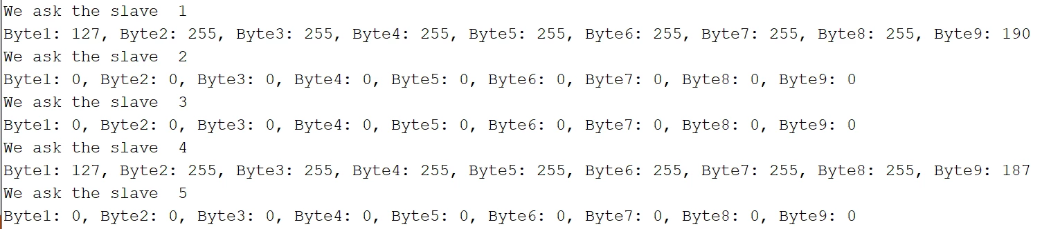

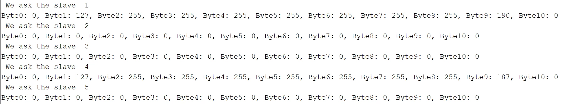

I have some suspicions that the 0 position of the receive buffer when receiving with the USART does not work.
I always get 0 in response[0].
If I comment the line of :
printf("Byte0: %d, ", response[0]);
printf("Byte0: %d, ", response[10]);
Reception of the message is correct
