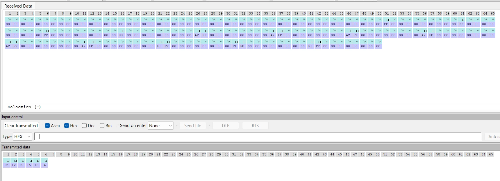

Hi
  i am receive data using UART 4 and transfer same data back like loopback but data is mismatch.
  same process in stm32f207 is working,
#include "main.h"
UART_HandleTypeDef huart4;
static void MX_UART4_Init(void);
int main(void)
char rx_buffer[10]={0};
HAL_Init();
SystemClock_Config();
MX_GPIO_Init();
MX_UART4_Init();
while (1)
HAL_UART_Receive(&huart4, rx_buffer, 10, 1000);
HAL_Delay(100);
HAL_UART_Transmit(&huart4, rx_buffer, 10, 100);
// HAL_Delay(1000);

@Naresh_ wrote:
I am receive data using UART 4 and transfer same data back like loopback but data is mismatch.
The commonest reason for receiving "junk" characters is wrong baud rate:
https://learn.sparkfun.com/tutorials/serial-communication/all#:~:text=If%20all%20the%20receiving%20device%20sees%20on%20its%20receive%20line%20is%20garbage%2C%20check%20to%20make%20sure%20the%20baud%20rates%20match%20up.
Baud rate depends on your clock setup - so check that.
Use the debugger to check if the corruption happens on reception or transmission - or both!
So look carefully at the differences between those two systems.
Again, use the debugger to see what is happening in the stm32f207, and compare/contrast what is happening in the STM32H753 ...

try resetting the buffer after transfer, also why different delays?
If full data is not received than it wont be sent as expected. Use a debugger to check if you receive what you are expecting.

Hi
      This is working in custom board but it's not working EVK board, what is issue?
Need to check your hardware differences on both boards: what is connected externally on UART4 pins apart of your looping-back wire?

Jul 24, 2024 9:50 AM UTC
Hi SofLit,
thank you quick response,
yes loop back is also requirement, but in receive side some data+ ACK is also loop back.
