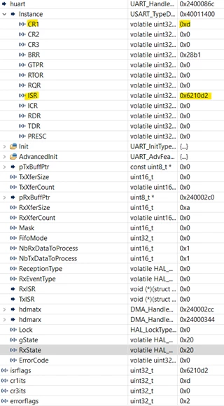

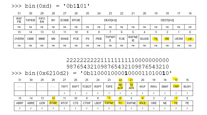

First, I have no clue why this IRQ is fired at all. In my understanding, in order to fire an UART IRQ, the appropriate enable bits must be configured in CR1-3. In this case, only in CR1 the RE, TE and UE are set.
Here is the content of CR1 and IRQ registers when the UART IRQ handler is fired:
Second, to my surprise, the HAL IRQ handler simply does nothing, no error is thrown or error callback is run. Seems to me that the frame error is only processed during receive. If no transmission is active, the frame error is ignored.
Any idea what caused the IRQ to be executed?

regjoeAuthor
Senior
Jun 5, 2025 6:44 AM UTC
Hi @Guenael Cadier ,
CR3 is 0, FE IRQ is not enabled. Here is what the debugger watch window looks like when the IRQ handler is entered and the local variables (isrflags, errorflags, ...) are read:
Guenael Cadier
Jun 5, 2025 6:57 AM UTC
As there's no interrupt source enabled in CR1 nor CR3, I have no explanation why IRQ Handler is called. I guess you already checked thet UART IRQ Handler call is properly associated to the right IRQn ...
