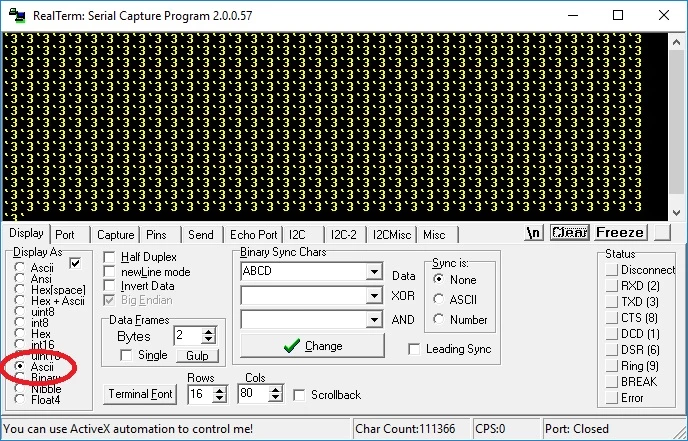

I have an STM32F1 and am running the UART printf example from the standard peripheral library. I've modified the code to allow me to use USART3 (I'm using a custom pcba and only USART3 is wired to a connector mounted on the board). I've connected USART3 to a serial terminal on my computer (RealTerm) using an FTDI USB-UART converter. I am successfully receiving data from the UART but the data is incorrect and the terminal complains of a framing error. I am transmitting a single character 'T' but am receiving unknown data:
I am convinced that there is a problem in my code, most likely in how I have configured USART3, but am not sure where. I have checked that my baud rate etc is good in both the code, cable and terminal.
Can anyone help me with this? What is the most likely reason I am not receiving the correct data?

Tesla DeLorean
Guru
May 19, 2017 6:13 PM UTC
Posted on May 19, 2017 at 20:13
Baud rate wrong (bad assumption about clock sources and speeds)
Wrong levels. Device outputs CMOS level, not RS232 level, which are higher and inverted.
Use 2-stop bits, creates a larger inter-symbol gap, if synchronization is an issue.
Try outputting a stream of 'U' characters and measuring bit timing on a scope.
Make sure to test for TXE before outputting to data register.
tonyblake9
May 22, 2017 2:12 PM UTC
Posted on May 22, 2017 at 14:12
Hi Clive,
As I said, I'm convinced that the problem in my code. Can you see anything wrong here:
void USART3_Config(void)
GPIO_InitTypeDef GPIO_InitStruct;
NVIC_InitTypeDef NVIC_InitStructure;
USART_InitTypeDef USART_InitStruct;
// 1) Clock Config
RCC_APB2PeriphClockCmd(RCC_APB1Periph_USART3,ENABLE);
RCC_APB2PeriphClockCmd(RCC_APB2Periph_GPIOB,ENABLE);
RCC_APB2PeriphClockCmd(RCC_APB2Periph_AFIO, ENABLE);
// 2) GPIO Config
GPIO_InitStruct.GPIO_Pin = GPIO_Pin_10; // USART3 TX
GPIO_InitStruct.GPIO_Mode = GPIO_Mode_AF_PP;
GPIO_InitStruct.GPIO_Speed = GPIO_Speed_50MHz;
GPIO_Init(GPIOB, &GPIO_InitStruct);
GPIO_InitStruct.GPIO_Pin = GPIO_Pin_11; // USART3 RX
GPIO_InitStruct.GPIO_Mode = GPIO_Mode_IN_FLOATING;
// 3) NVIC Config
NVIC_InitStructure.NVIC_IRQChannel = USART3_IRQChannel;
NVIC_InitStructure.NVIC_IRQChannelPreemptionPriority=0;
NVIC_InitStructure.NVIC_IRQChannelSubPriority = 0;
NVIC_InitStructure.NVIC_IRQChannelCmd = ENABLE;
NVIC_Init(&NVIC_InitStructure);
// 4) USART Struct Config
USART_InitStruct.USART_BaudRate = 115200;
USART_InitStruct.USART_StopBits = USART_StopBits_1;
USART_InitStruct.USART_WordLength = USART_WordLength_8b;
USART_InitStruct.USART_Parity = USART_Parity_No;
USART_InitStruct.USART_HardwareFlowControl = USART_HardwareFlowControl_None;
USART_InitStruct.USART_Mode = USART_Mode_Rx | USART_Mode_Tx;
USART_Init(USART3, &USART_InitStruct);
USART_Cmd(USART3, ENABLE);
Tesla DeLorean
Tesla DeLoreanBest answer
Guru
May 22, 2017 2:18 PM UTC
Posted on May 22, 2017 at 14:18
USART3 is not on APB2
