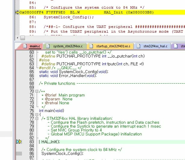

Hello STM32 users,
I've received the STM32F401RE board and am trying to run a test program on it. I downloaded uVision5 and the STM32Cube_FW_F4_V1.9.0 and opened the UART project that came with the package. The ''DM00107720-Getting Started with STM32CubeF4 firmware package'' document says I can just run it on uVision5. I don't know much about the ARM architecture let alone S TM32. I see COM16 port is seen on my PC but when I debug run the program, a yello and bright green arrow is pointing the first line of the main() program which is HAL_init(); as in the image below.  I can press F10 to proceed but when I cross the printf statement, nothing comes up on my teraterm windows. (set to use COM16, 9600,odd,8,1 as the USART setting in the program). I guess I'm missing something very basic. What is wrong with my case?
regards, Thanks,
Chan

    Posted on November 26, 2015 at 15:14
    It's really using ODD parity?
    Keil would need retargeting code where the fputc() actually implements the output to the specific USART.

    Posted on November 27, 2015 at 01:57
    Hi, clive1,
    in the main.c file, it is defined as below. Isn't it correctly set already?
    #ifdef __GNUC__
      /* With GCC/RAISONANCE, small printf (option LD Linker->Libraries->Small printf
         set to 'Yes') calls __io_putchar() */
      #define PUTCHAR_PROTOTYPE int __io_putchar(int ch)
    #else
      #define PUTCHAR_PROTOTYPE int fputc(int ch, FILE *f)
    #endif /* __GNUC__ */
    PUTCHAR_PROTOTYPE
      /* Place your implementation of fputc here */
      /* e.g. write a character to the EVAL_COM1 and Loop until the end of transmission */
      HAL_UART_Transmit(&UartHandle, (uint8_t *)&ch, 1, 0xFFFF);
      return ch;
    Also, the USART is set as below (see odd parity).
      UartHandle.Instance          = USARTx;
      UartHandle.Init.BaudRate     = 9600;
      UartHandle.Init.WordLength   = UART_WORDLENGTH_8B;
      UartHandle.Init.StopBits     = UART_STOPBITS_1;
      UartHandle.Init.Parity       = UART_PARITY_ODD;
      UartHandle.Init.HwFlowCtl    = UART_HWCONTROL_NONE;
      UartHandle.Init.Mode         = UART_MODE_TX_RX;
      UartHandle.Init.OverSampling = UART_OVERSAMPLING_16;
