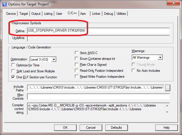

    I have error: ''main.c(33): error:  #20: identifier ''NVIC_InitTypeDef'' is undefined''.
    In which file it is defined?

    Posted on March 14, 2013 at 01:28
    stm32f0xx_misc.h via stm32F0xx_conf.h via stm32f0xx.h, when USE_STDPERIPH_DRIVER is defined in project

    Posted on March 15, 2013 at 17:10
    Probably I don´t have defined ''USE_STDPERIPH_DRIVER'' in project.
    Please, how and where I can define it? You think preprocessor symbol?

    March 15, 2013
    Posted on March 15, 2013 at 17:39
