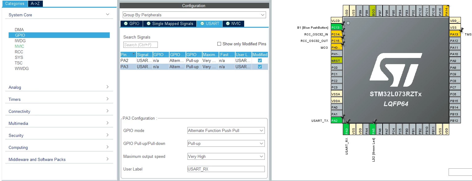

My STM board is STM32-L073RZ.
I've had a lot of problem with HC-06, tried to somehow send the command "AT" or "AT\r\n", but I didn't get anything back. The bluetooth wasn't connected to any device because the diode was blinking.
- I tried changing the Baund Rate from 9600 to higher it didn't work.
- I've tried to add Pull up on TX,RX (I've read maybe it doesn't have internal so I've added but it didn't work) :
- I've even took off the voltage divider and it didn't work, It was added from the start like in this example :
Here is the code :

I also thought that Arduino didn't add pull up for the HC-06 but maybe they have always turned on ? So I have to add pull up for STM32, I did but it still didn't work. I was expecting and "OK" response instead I had "--" and the response array was empty.
I don't know where is the error.

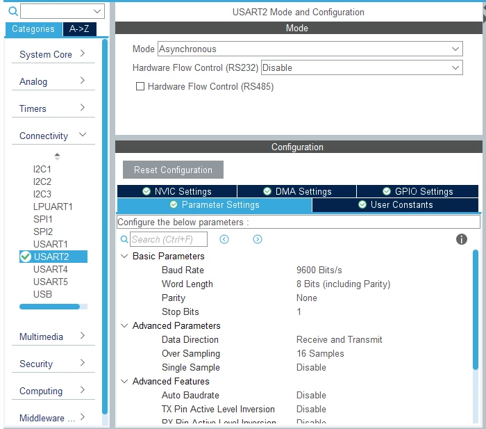

set : 9600 , 8N1 ;
AND HC-06 is slave , so you only can connect from your mobile to the hc06 , not other way.
Xenon02Author
January 6, 2024
Here is the actual setting for the UART :
I think it is the same like you've described "9600 , 8N1 ;"
And I've also taken of the R1 and R2, but it still doesn't work.

8N1 , yes, ok.
Why using uart2 , which is connected to st-link onboard ?
Try with uart1 , PA9 + 10 .
(or remap inCube uart2 to pins PA14 + 15 , if possible )
HC-06 module first should be accessed by BT-master, maybe your mobile . (try: connect there)
When connected, you can send ... then.

Xenon02Author
January 6, 2024
What is "SB13 and SB14 ON, SB62 and SB63 OFF" where can I find it ?
I am using the Arduino connectors which is D0 and D1, and set the pull up in both D1 and D0.
