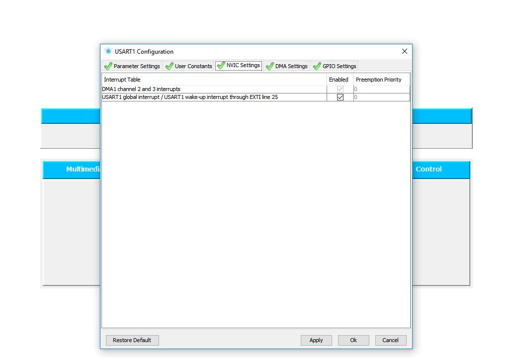

Hello again. I've been trying to get my mcu to transfer a buffer via UART to my computer with the help of DMA.
for some reason, it does not appear to be working. I think my computer recognizes it correctly just as when I am
not using DMA but for some reason i am not receiving the information on my computer.
Thank you very much for your help.

    Did you enable the Uart Interrupt ?
     and start the DMA ?
        HAL_UART_Receive_DMA(&huart1, (uint8_t *)Usart1RxDMABuffer, U1RxBufSize);

    Thank you for your reply. I should have given more information. I apologize. I am using the discovery board for the stm32f072rbt6. I am trying to use the dma function to send values from the adc to my computer. It does work without dma (only hal_transmit_fs) but not with it.
    To answer your questions. I did enable the Uart interrupt via Cube and I did start the dna. My main is attached to the original question as a text file. But just to be sure I have attached the settings below.
    //start dma
    HAL_UART_Transmit_DMA(&huart1, (uint8_t *)bufftr, sizeof(bufftr));
    //Interrupt settings
