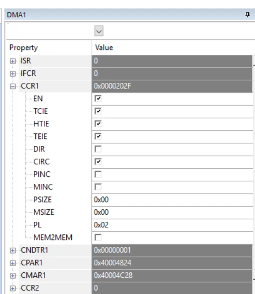

UART DMA INT is not working
Posted on June 16, 2016 at 10:30
I'm facing a strange problem with UART DMA int in a FreeRTOS-based project. When I call the DMA setup function (below) from a given FreeRTOS task, it works just fine and the ISR is executed. However, when I call it from a different task, the DMA ISR is not executed at all. Although all DMA interrupts are enabled and the DMA channel itself is enabled.. ( I can see the registers in uVision debug mode). Below you can see register values. I don't know why the ISR is not executed. The DMA transfers only 2 bytes (instead of 10) and then stops. I double checked the DMA settings they are the same in both tasks.. 0690X00000605PtQAI.png

__HAL_LINKDMA(huartSrc,hdmarx,portPortDMA1);
/* DMA interrupt init */
HAL_NVIC_SetPriority(DMA1_Ch1_IRQn, 1, 0);
HAL_NVIC_EnableIRQ(DMA1_Ch1_IRQn);
/* Start DMA stream */
dmaStreamDst[0] = huartDst;
huartSrc->State = HAL_UART_STATE_READY;
HAL_UART_Receive_DMA(huartSrc, (uint8_t *)(&(huartDst->Instance->TDR)), num);
